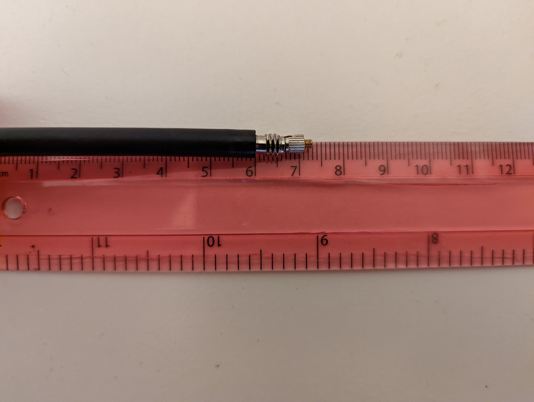

Is that the total length or just the tube part before the head (don't know the technical name). My Vittoria tubes are listed as 46mm but that excludes the head of the tube

Hope this helps:Tifosiphil wrote: ↑Fri Apr 08, 2022 8:43 pmIs that the total length or just the tube part before the head (don't know the technical name). My Vittoria tubes are listed as 46mm but that excludes the head of the tube

Absolutely perfect, thank you. Should be able to get it to work without an extender!Mog88 wrote: ↑Sun Apr 10, 2022 2:08 pmHope this helps:Tifosiphil wrote: ↑Fri Apr 08, 2022 8:43 pmIs that the total length or just the tube part before the head (don't know the technical name). My Vittoria tubes are listed as 46mm but that excludes the head of the tube
