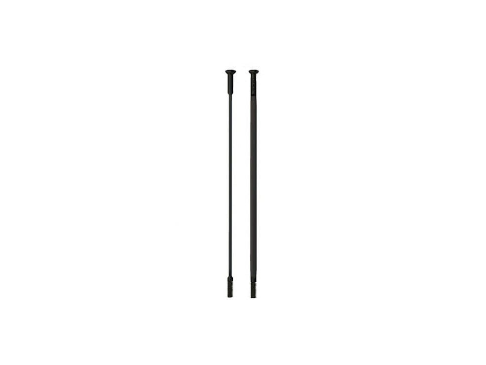

In my wheel design spreadsheet 44 thin aero spokes come out as 198g, so I'd go with the lower figure.
Luckily r2-bike weighs everything.
Edit: On their english site the picture of the CX Super was shown and not the CX Ray...
So it's 210g plus 15g - 225g is correct for 280mm CX-Ray straight pull spokes.
For 44 CX Super 280mm and nipples 190g:
