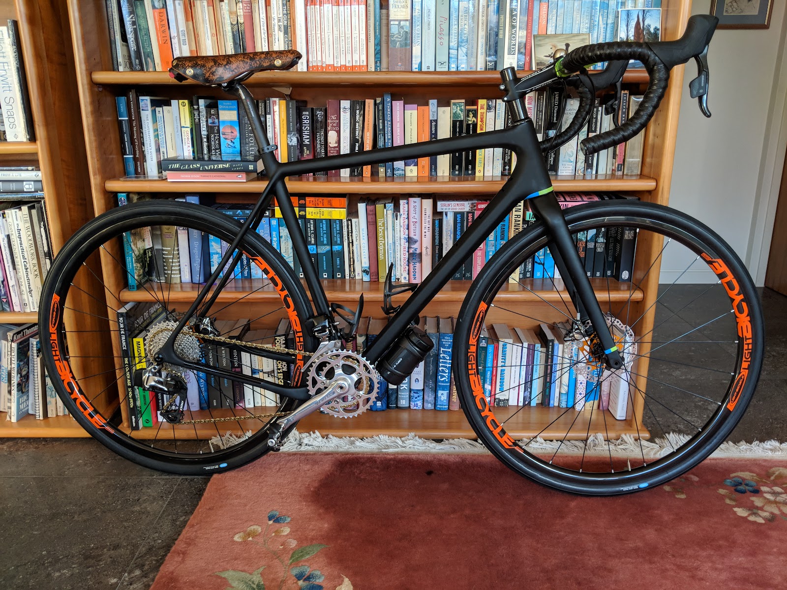

I setup my Open U.P.P.E.R. with SRAM eTap WiFli (11-speed 2x). Chainrings are 42-29 on a 94 BCD crankset (Middleburn RO2) and cassette is an Ultegra 11-34 (SRAM says 32t max cog for WiFli but it swallows the 34 without any problem and there's enough adjustment left on the B screw for a 36 if I wanted). I find the gearing is pretty good for everything from bunch rides on bitumen, where the small chainring hardly ever gets used unless there's a substantial climb, to single track, where it gets used a lot. I built two sets of wheels for it, a 700c set with Light Bicycle rims on which I have been running Compass Bon Jon Pass 35mm tyres, and a 650b set with MCFK rims and Panaracer Gravelking 48mm tyres. I stick on the 650b set if singletrack is part of the ride, and for everything else use the 700c set.
