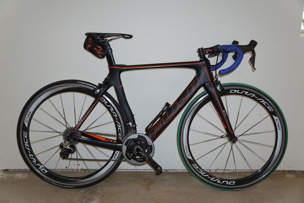

I'm a climber but also newly minted aerogeek. I just built up this Fuji Transonic. The aero benefit is quite amazing.
Gorgeous bike, I'm looking forward to becoming an Aerogeek also. This is the first bike that makes want to go Aero.

CanadianBiker wrote:Gorgeous bike, I'm looking forward to becoming an Aerogeek also. This is the first bike that makes want to go Aero.
Thanks. GL with your purchase. I'm a smaller guy so on group rides I used to wait for the hills to make my move. Now with the Transonic I make my moves on the downhills. I never imagined that a bike change would also make me change my style of riding :D I'll admit part of the speed change is psychological. But it's so much fun when you are hammering at speed on an aero bike.
