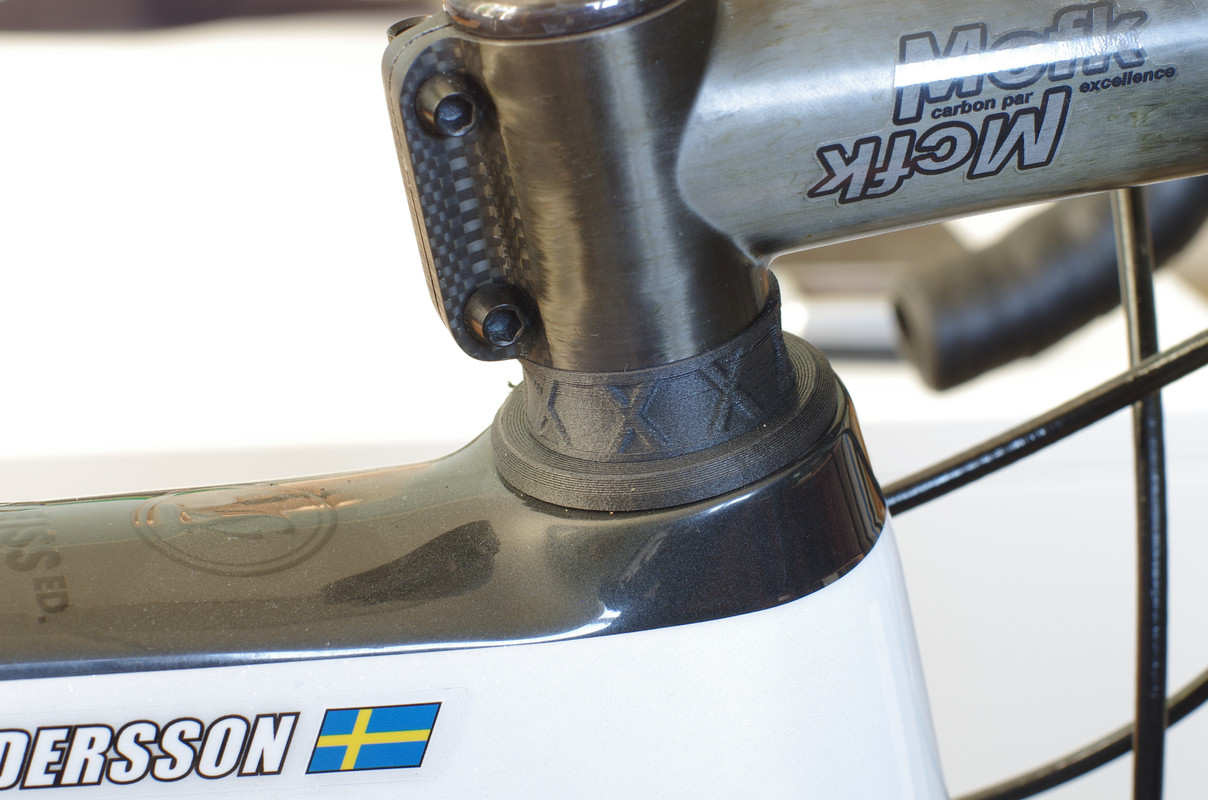

I managed to save some additional weight by making my own headset spacer out of carbon fiber reinforced nylon (just like the Extralite ones);

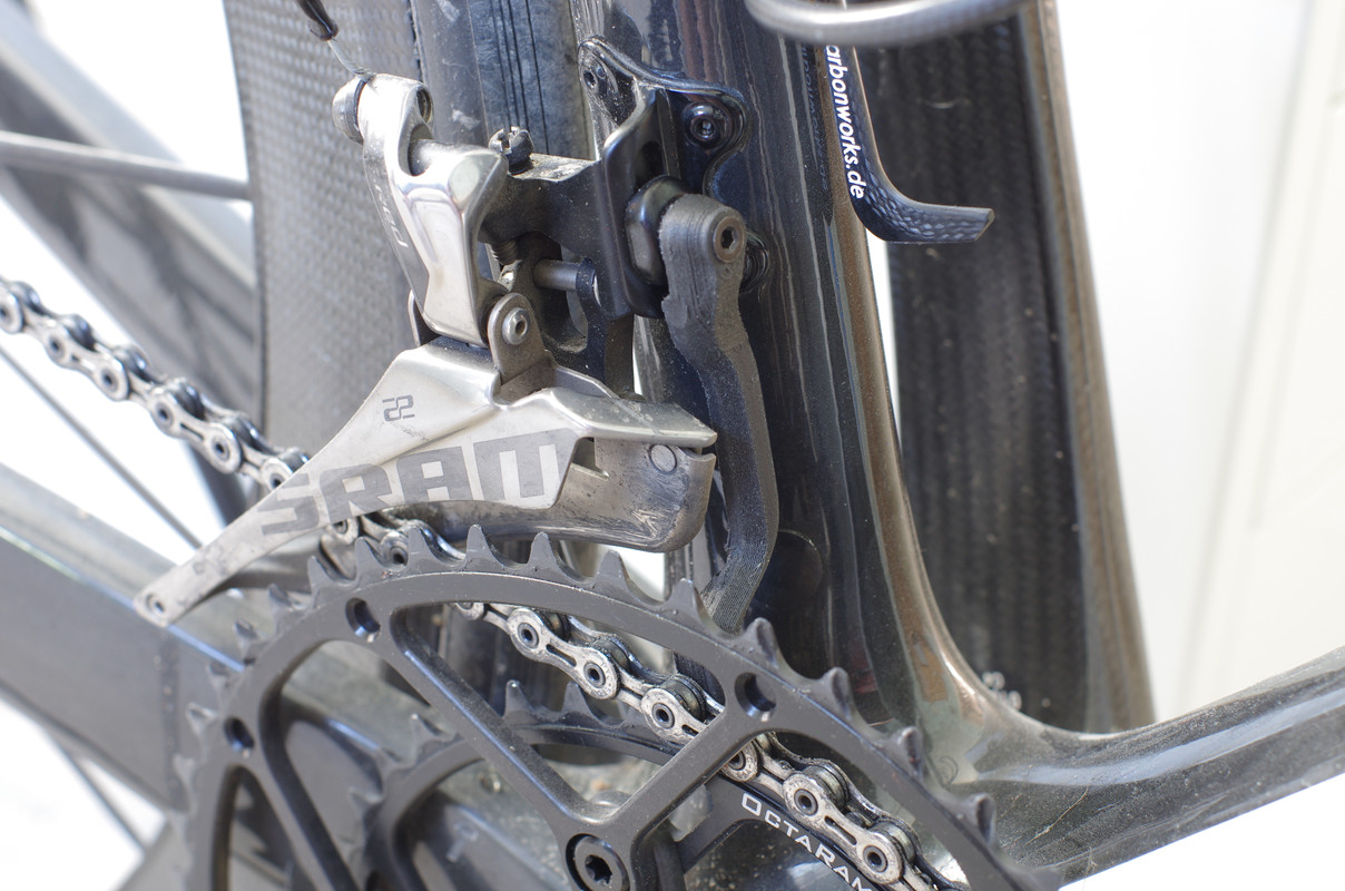

And I saved a whole 5,0 grams by making the SRAM chain catcher out of the same material;

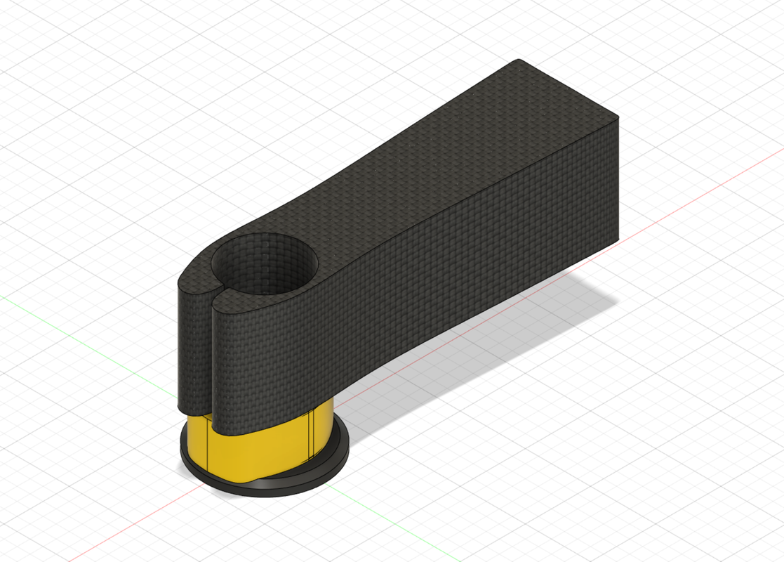

The original internal cable stops on the Urgestalt frame are made from aluminium and are quite heavy ay 3,2 grams;
So I printed some from cf nylon at 1,3 grams;
The frame has three of these so the total weight saving is 5,7 grams! :)

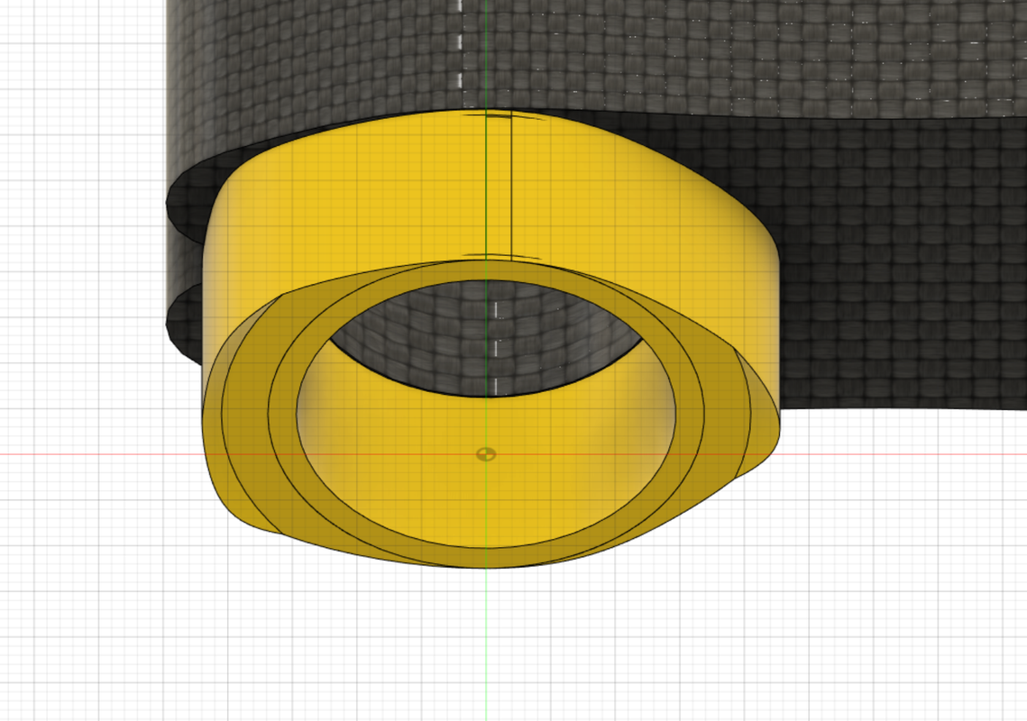

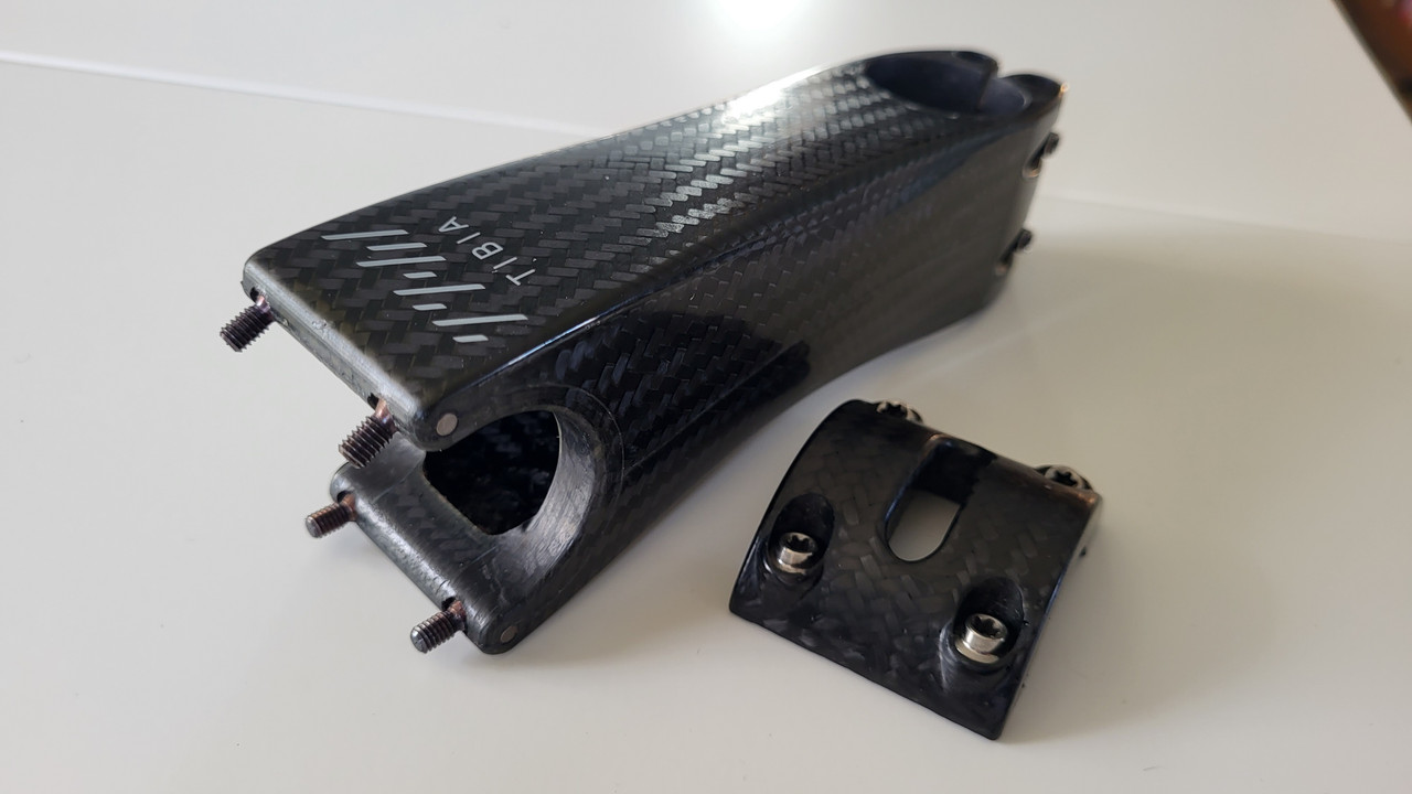

I got a new stem for Urgestalt. A THM Tibia in 110mm size, weighing an impressive 82 grams.
Now to figure out how the headset spacer should look;

Very nice!!!!
