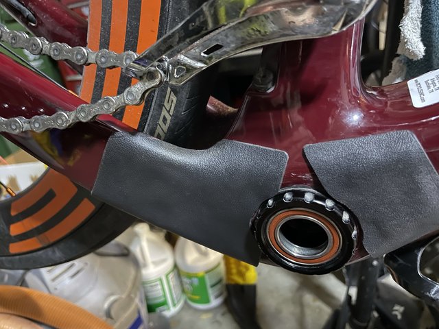

I removed mine, used some 3M PPF for a little bit, but decided to make one out of 1.3mm KYTEX as I wanted a bit more protection from rocks.

Do you have a picture of yours? @IrrelevantD

bmCube wrote:
Tue May 24, 2022 7:11 pm
Actually, I don't. I used the same stuff to make some protection against dropped chains around the bottom bracket. I didn't take any pictures of what I made for the downtube.
* There is a 70% chance that what you have just read has a peppering of cynicism or sarcasm and generally should not be taken seriously.
I'll leave it up to you to figure out the other 30%. If you are in any way offended, that's on you.
bmCube
Posts: 105
Joined: Wed Jan 05, 2011 8:37 pm
by bmCube
:thumbup: okay, looks nice and sturdy around the bb.

Seems a bit excessive. Wouldn’t it be lighter and more aesthetically pleasing with a chain catcher?

kode54 wrote:
Fri May 27, 2022 1:58 pm
that's part of the problem. Had a chain drop, get caught by the chainring bolt and ripped past the K-Edge catcher... actually bent and ruined the catcher. So not only did the chain damage the paint all the way down to the carbon on the downtube and chainstay, but the catcher scratched the paint as well. I actually went a step further than KYTEX and more recently replaced my crank arms with SRAM's "wide" arms to get another 2.5mm of clearance between the rings and the frame.
As for the weight... KYTEX is pretty light. I'd bet that all of the material I've used on my frame weighs about the same or less than the factory rubber protectors and an alloy chain catcher. I also have a D-Four power meter, so it's all completely hidden behind the spider.
