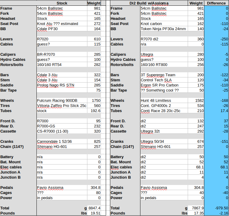

I've having a hard time figuring out how people are getting to <= 17 pound weights with the new Supersix Evo. Here is a chart, On the left is what I belive the stock 105 build to be (with my own pedals/cages/etc). The right is my currently planned build starting from the 105 frame. If anyone can see where I can significantly reduce weight or knows of any inaccuracies please let me know. All component weights are in grams, the final build weights are presented in grams and pounds.
In case image doesn't load inline: https://postimg.cc/1nrx7Fk9

Easiest / cheapest way to save weight would be to go tubeless and lose the butyl tunes. You could also lose a pound with lighter wheels. But not cheap. Hi-Mod frameset, DA rather than Ultegra, SISL2 cranks and a spider PM (SRM or P2Max) anf lighter pedals would all result in weight savings. I'm expecting mine in 56cm to be well under 15 lbs.
EVO1 | 5.37kg
EVO3 | 6.51kg
SystemSix | 8.01kg
P5 | 9070 Di2 | SISL2 SRM | Enve 7.8/FFWD Falcon | Roval 321
T1 | P2Max Type S | Rolf Prima FX58/Zipp Super 9 Disc

hernejj wrote:
Sat Oct 12, 2019 2:27 am
I'd start with a lighter cassette, lighter tubes (or tubeless) and lighter rotors. You can easily save 300 grams just there. I have the same frame set and built it to 7,1kg with Red Etap 11 speed.
