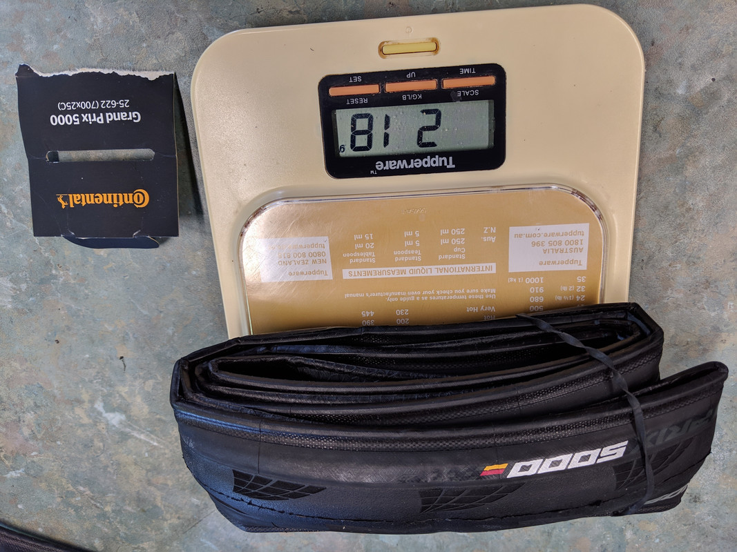

My pair of 25mm 5000 clinchers arrived.
Weights are 218 and 226g for an average of 222g:
Imagemeaning of payton girl
They measured 25.5mm when first mounted on my Boras (17mm internal) and then 26.1mm after an 80km ride.
Cheers
