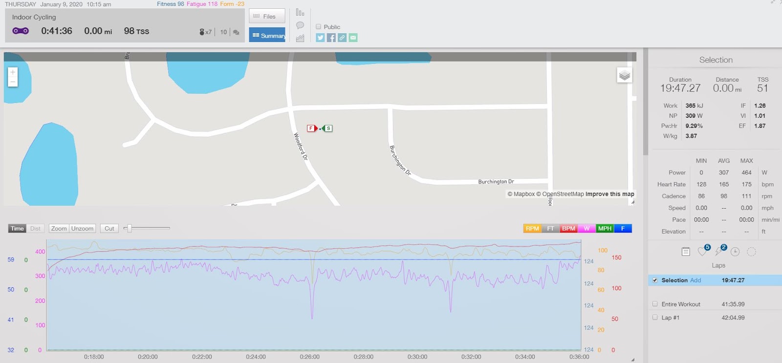

I wish I had the data from the Tacx but I do not. This is the 20min segment done for the FTP Stages Gen 3, Bontrager heart rate strap. Take it easy on me this is my first go at this. With the Tacx it recorded my FTP test at 240w but with the HR numbers recorded below on my Garmin.
Then comparing data from my regular early morning group ride. Yes, it's a group but power is power and heart rate is heart rate. That's my thinking but please correct me if I'm wrong. Lower average watts but my HR is much lower as well. This was a pretty easy ride also just a tempo pace. Laps 2, 3 are nearly identical, with no stops. That's about 20 minutes of solid riding. Lap 4 is the same but we turn off before the lap start point so the time is off a bit. So with my average HR of 125 and average watts at 271 for 20 min, really even longer if I include lap 4. Is that an unusually high watt output for the work? I'm 5'10" 173ish lbs. Just looking down doing a 30second average at 240watts is just cruising at around 21-22mph, I can do that for well over 20 min with my HR around 135-140. I know indoor numbers will differ from outdoor. But by how much? I'm new to all this just trying to figure out what the discrepancy is. Also how many watts is considered "easy" or "hard" everyone will have a different number so that's hard to compute.
