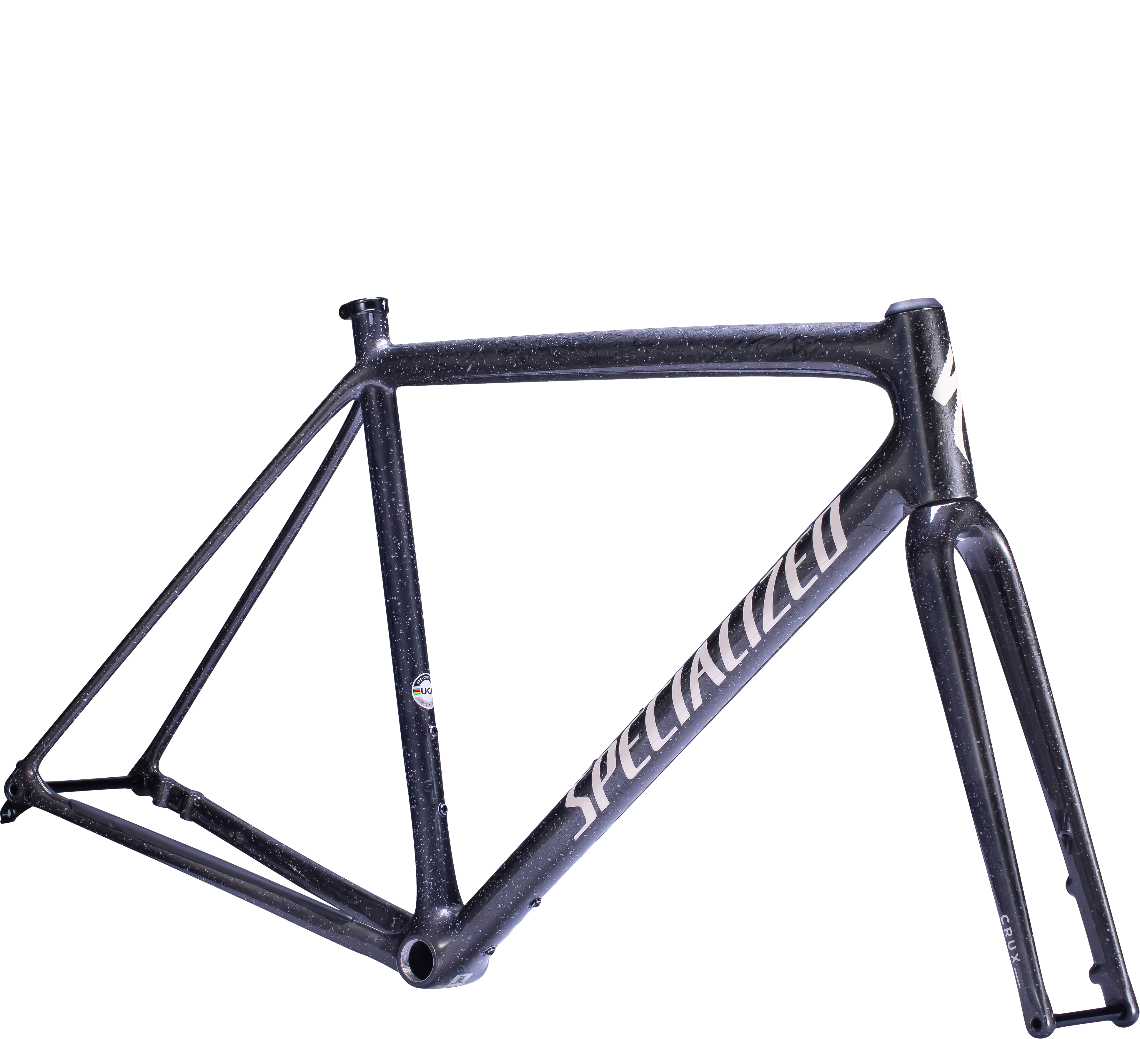

Anyone has or has seen the Gloss Carbon/Smoke/Grey Granite colour in person and can share photos or description. I find it very difficult to imagine it based on the frame only studio photo on website
https://assets.specialized.com/i/specia ... 0&fmt=auto
