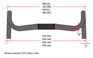

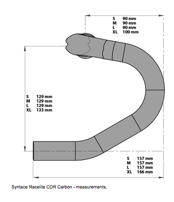

I use 46cm for everything. Syntace Racelite CDR Carbon XL: https://www.syntace.com/en_GB/products/ ... -carbon-xl
