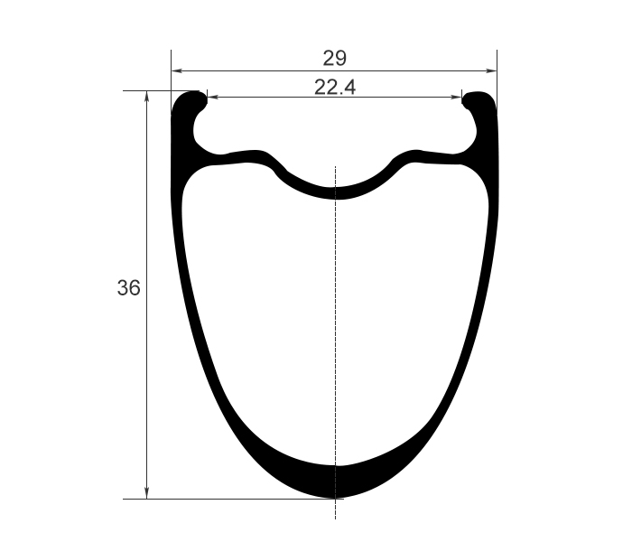

Noctiluxx wrote:My preference is to use 35-40mm carbon wheels but I can get the Black Inc. 50mm Carbon wheels for $900. What do you think?
I would strongly consider Light Bicycle's WR56C02 or WR46C02 for graveI use, I think the price tag will end up close to $900.

Jugi wrote:
Mon Dec 24, 2018 7:15 pm
Yeah just realized those Black Inc wheels are only 17mm internally wide. Not gonna work!

AJS914 wrote:
Mon Dec 24, 2018 9:07 pm
I'd want aluminum rims for gravel. Do you need the aero benefits? I ride my gravel bike on mountain bike trails so I'd be affraid of damaging carbon rims.
Sounds pretty nonsensical to me. My gravel bike has Light Bicycle 650b RG722 carbon rims, and I've had zero problems with them over all sorts of terrain, running either 38mm tyres for rides that are mixed bitumen and fire road, or 48mm tyres for the rougher stuff. To get the same sort of durability from aluminium rims, you'll be going at least 100g heavier per rim.
