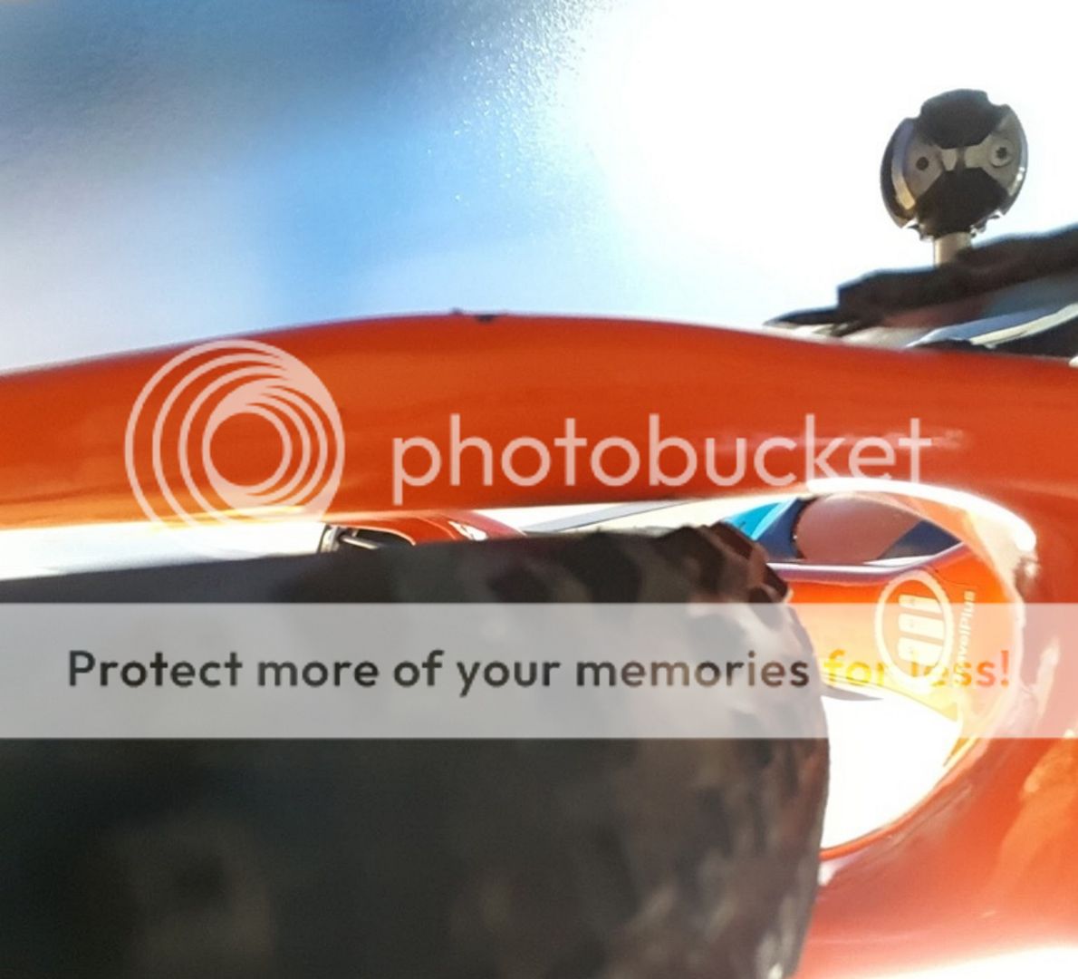

A big turn off for me on the up is the slack STA designed around a straight post. Weird for a bike that needs good tire clearance. I recently checked one out at a store and the rear tire was very close to the seat tube. I also hate the look of straight posts.

UpFromOne wrote:47mm is only a 1.85" section tire, looking for up to 2.2 like the U.P.
I know it is tire and wheel dependent but my up is perilously close on the DS chain stay with 2.1 Schwalbe Thunder Burts on there. I had some rub marks on the chain stay that someone suggested might have been mud build up on the tire and that is likely the case.....any how, point is I don't think I would run anything wider than 2.1" even though I have seen some builds with 2.25".
