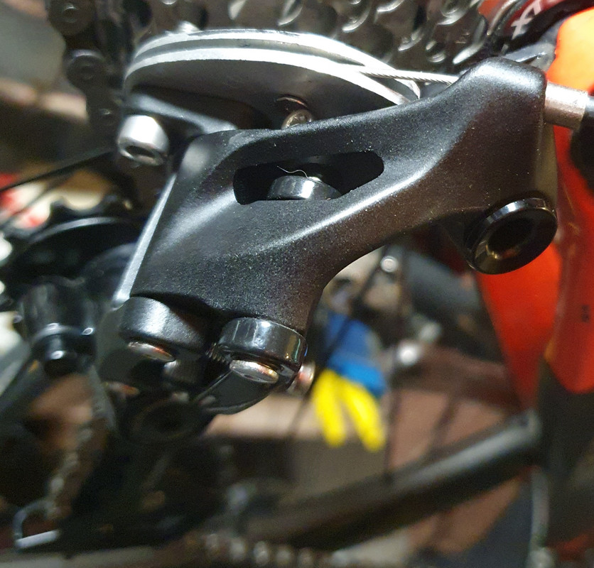

This has been a while - but I'm getting there. 3 pieces of 1.6mm alloy a hacksaw and a file.
After playing with a drafing tool for a while to get an "exact" shape that probably wouldn't work due to cable tension and general play in the system,
I transferred an approximate shape to the alloy and cut/filed. It was half a click too short across the cassette on first go,
after an hour or so with a file it appears to index an 11-42 Shimano XT cassette with the Capag 2x11sp HO levers OK on the bench.
I'm yet to give it a solid out of the saddle shifting test as it is pi$$ing down rain here
- matthew

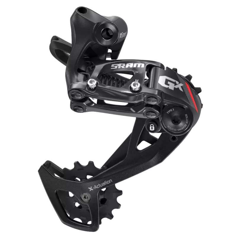

@satanas - its an SRAM GX 2x11
https://www.sram.com/en/sram/models/rd-gx-11-a1
The important bit is max tooth = 42
originally it shifted X-actuation.
RatioTechnology were not aware of the GX 2x11 derailleur and aren't that interested in Campagnolo 2x11.
- matthew

The GX 2x11 derailleur has a different shape fin and it attaches to the derailleur in a different position - Ratio have not designed a fin for the GX 2x11 as they thought it was riveted, and were not aware that the fin had circlips and was replacable.
They also said that "the market" was not interested in 2x drivetrains with mixed brands (Campag shifter/SRAM derailleur).
