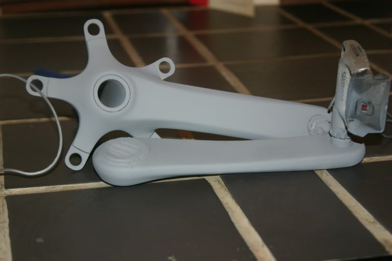

I have had a go at this with an old set of Red cranks, Hoping to get a matt finish
I built a high tech spray booth
I have given them a coat of primer
1st coat of paint
2nd coat
