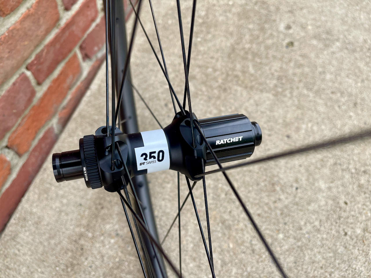

Got an update on the new dt350 road hubs- turns out there was a big stockpile of the old hubs and they've just worn through them. I don't believe there's been an announcement about the updated versions yet but I've got some pics and weights. looking much more refined, cleaner and crucially lighter. does a good job closing the gap between the 240s and greatly increases the value proposition.

If they're still using 6902s across the board and the non-EXP ratchet at that weight...that's pretty awesome. Maybe 55-60 grams heavier than a 240 set.

when the mtb hubs came out they did a full individual parts weights breakdown and I think a lot of that applies here. Still non exp but new hollowed out SL star ratchet rings cut a big chunk of weight. I hadn't thought about bearings though- lets hope they're still big and chunky!
Are those decals/stickers removable or are they perma - like the 240's ?PatchuaPatcherson wrote: ↑Thu Nov 24, 2022 1:38 pmGot an update on the new dt350 road hubs- turns out there was a big stockpile of the old hubs and they've just worn through them. I don't believe there's been an announcement about the updated versions yet but I've got some pics and weights. looking much more refined, cleaner and crucially lighter. does a good job closing the gap between the 240s and greatly increases the value proposition.

No confirmation on the decals sorry- they certainly look like they could be a glossy sticker from the images which would be my preference.

Got a wheelset built with these in hand today- still no official release from DTSwiss?
They look great. Decals are not stickers but a higher end semi gloss as seen on some 3t stems etc. potentially same as 240s. 36t ratchet. Haven't got the tools to disassemble and check bearings sorry. Any other questions about these hubs?

Sticker is the most obvious difference, although hub machining has more square edges vs the slighter rounder edges of previous-gen 350

the pinkbike pics and writeup is for the mtb version, but these roval hubs are definitely the same road version as mine. Strange that they'd identify it as a 340 even though the decal clearly shows 350.
