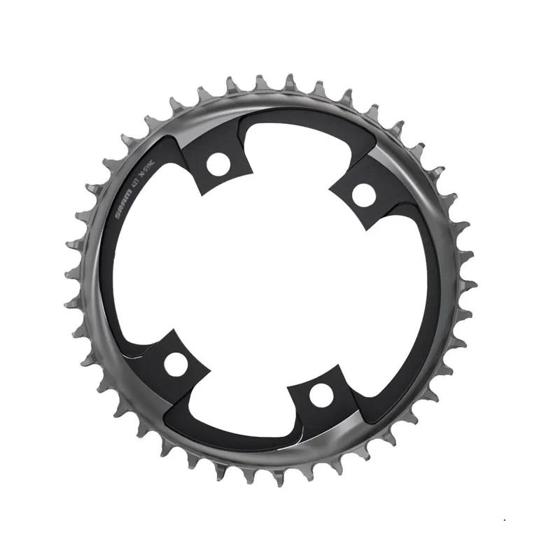

I have a couple of Red AXS 1x 107bcd chainrings sitting spare. This type
https://www.certini.co.uk/images/SRAM-C ... -grey.jpg

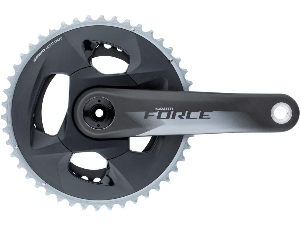

I've ordered a Rival AXS 2x crankset with the quarq power meter on the left had side. The right hand crank arm has the 4-arm 107bcd spider built into the arm.
I have read in reviews that say Rival 1x cranks and Rival 2x cranks can not be converted from one to the other. But is this actually true? The 1x Rival crank has a right hand crank arm that uses the 8-bolt direct mount interface that is seen on Red and Force crank arms.
It seems to me that there would be nothing stopping me using the Red 1x chainring that I have (the one pictured in the link above) with the 2x Rival cranks that I have ordered since they are both 107bcd.
Can anyone confirm this?
I guess I'll find out soon enough, the cranks will arrive in a few days but just thought I'd ask here.
Another point woul be that the Rival axs 1x cranks that use the 8-bolt direct mount interface could easily be converted to 2x using the 107bcd force/red spider.
Another question, the Rival 2x chainrings must be compatible with Force and Red crank arms as they would mount on to the 107bcd spider, right?
I've not managed to find any examples online of folk experimenting with mixing it up with the Rival crankset.
Just curious to know if anyone here has any experience?
I'll update when I get the Rival Quark crankset

Sorry, misunderstood your queston:
For Rival 2x the mounting is (from frame -----> out to pedal)
Bolt -> Inner Ring -> Integrated Spider -> Outer Ring/Rivnut
where the bolt secured directly into the Outer Ring/Rivnut
However for Red/Force 1x the mounting is:
Bolt -> Spider -> 46t Ring -> Plastic Cap/Cap nut
So for using the Rival arm it would need to be similar to above. You would need the plastic cap/cap nuts, and it might not fit flush with the Rival integrated spider. BCD seems the same at 107.
Rival AXS is thinner and straight, while Red/Force is wider and rounded:
Think the issue is how to secure the 46t red chainring to the integrated Rival spider. While it looks like the 2x Rival chainrings use the same bolts as the Red/Force 1x chainrings, it's how the bolts secure the chainring itself that could be an issue.carbonsinglespeed wrote: ↑Thu May 26, 2022 11:38 pmI have a couple of Red AXS 1x 107bcd chainrings sitting spare. This type
