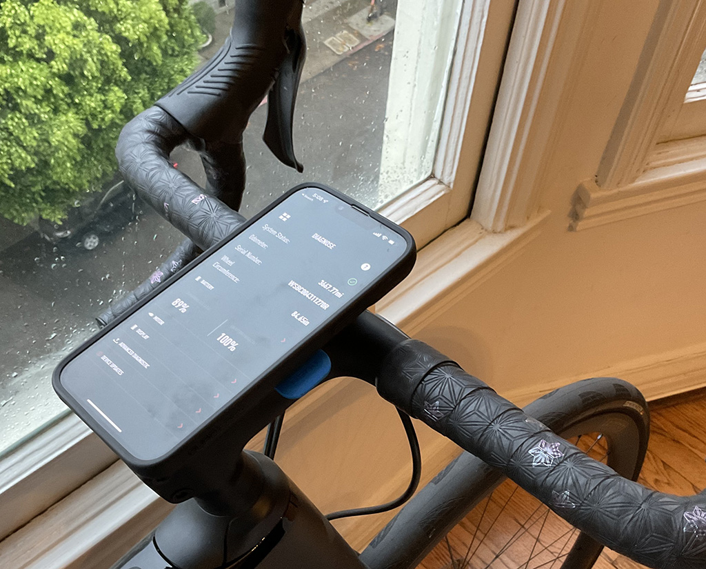

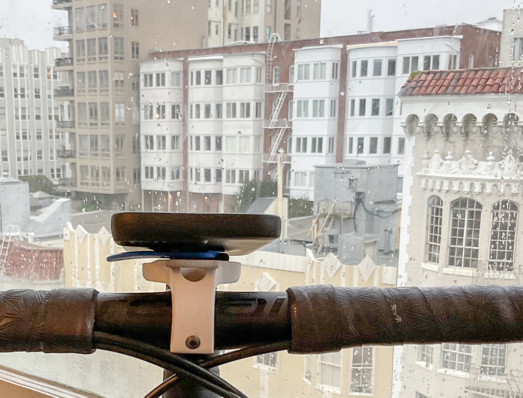

does anyone else who has this bar/steam know about the strength of the M4 threaded mount up front? i'd like to use it for a flipped around "up top" mount as opposed to "out front," but with an iphone rather than a bike computer. certainly quite a bit more load than a bike computer. it seems solid, plenty of engagement, but i'm worried about the constant up and down stresses on it while riding.
3d printed mount is a work in progress, obviously! apologies for the terrible pics. for some reason the tag isn't working...
http://www.431.org/miscPics/0074-mounted.jpg
http://www.431.org/miscPics/0073-badPicFront.jpg
