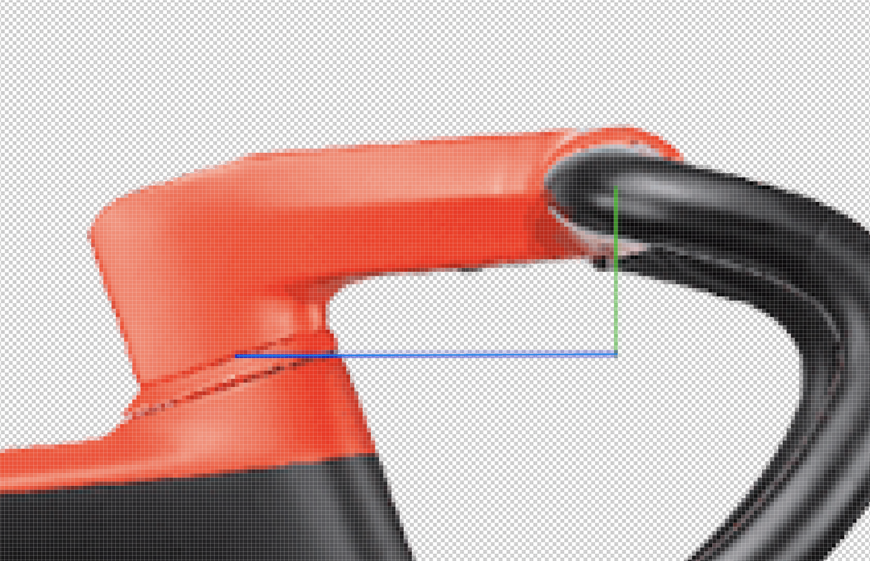

Hey everyone! I'm considering BMC Teammachine with ICS cockpit as my next bike and I'm trying to work out the frame sizing. But in order to do that I'd need to know some dimensions of the ICS cockpit, which unfortunately are not listed anywhere on the BMC website. And I don't want to end up with 50mm of spacers under the stem or handlebars too wide.
1. What's the effective stack of the ICS stem? The stem angle is listed as -12, that's fine. But it looks to me that BMC has opted for a stem that's mounted higher and is more inclined. Please refer to the pic below - I'm looking for the length that's painted in green, so from bottom of the stem (center) to handlebars center.
2. How is the handlebars width measured? Center to center or oustside? I'm usually riding 400mm center to center. BMC only offers the 400mm option in 90mm stem length :(
The handlebars is meassured center - center. I have a 40cm ICS Cockpit and that is 36cm on the hoods ( slightly inwards ). BMC also offers longer stems for smaller widths - and I ordered mine at Bike24 in Germany. It is called the team edition and on stock in 110 to 140mm, at least the red one. They also have the white /b lack one and completely black one like I have. The stack I have to meassure , but I will do that for you.
