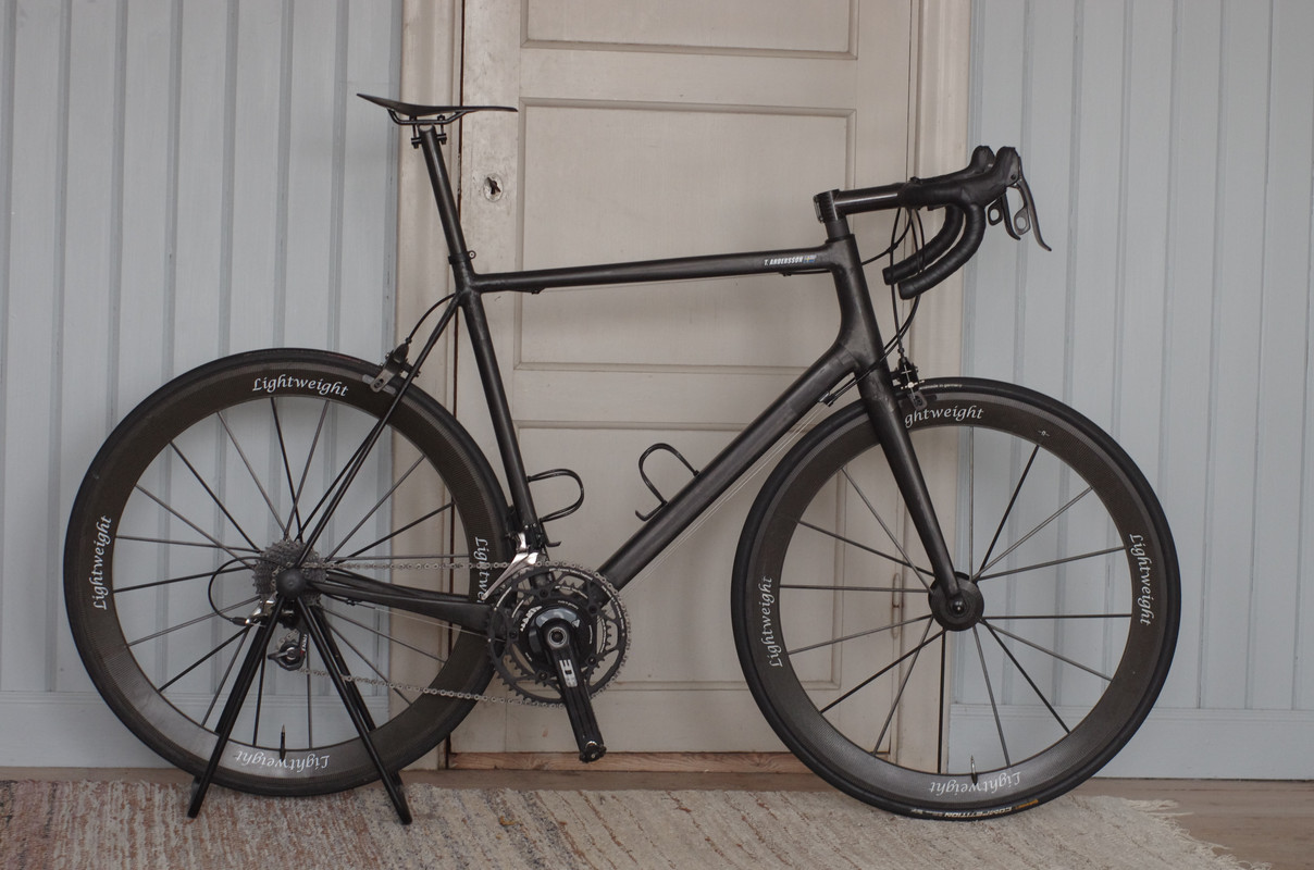

A little update on the final touches of the paint removal project.
I painted the entire frame set with a 2K adhesion promoter and subsequently a 2K polyurethane clear coat. I didn't use more than 5-10 ml of paint and still got a deep gloss and wet look.
The nude carbon is conductive and ages the aluminum riv-nuts quite rapidly, so I replaced the riv-nuts;
The bike before the clear coat with just Aerospace 303 UV protectant;
The bike in it's current state;
