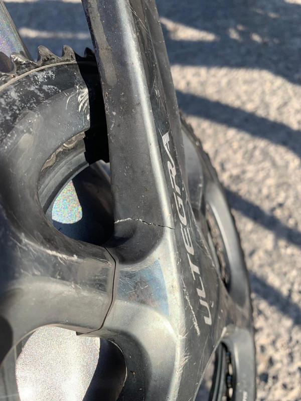

Several months ago I replaced the chain on the DA. The next ride I notice a pop on some heavy load downstrokes happening on the left side that was never there before. Change the chain to a new one and it seems to disappear. Month or so later it comes back. I remove the crankset, check, clean and replace. It goes away again. The last time, after the same climb where I initially noticed the first pop/ping, the noise happens again every pedal-always on the left side. Take it to the shop. They replace grease bb. The noise stays. Take it to second shop and they notice the crack.
Now on the 8000 it was different. I was on some serious climbs(for me) two weeks ago in the Smokey Mountains and no problem. Come home and on the first ride—on my hardest daily climb, which as I said I try to sprint up, I notice the popping every down stroke accompanied by a large wobble. Looked and they’re the crack was in the same spot as on the DA. There was never any popping until it broke.

It looks like in most/all cases da/ultegra fails on right crankarm. Shimano can fix this problem by using spiderless (direct mount) design
For the 1st glued mtb crankset FC-M9000 shimano used hollow bonded (glued) design on left crankarm only (right crankarm was hollow forged).
Newer FC-M9100 have both crankarms hollow bonded (glued) + direct mount chainring (no spider, left & right crankarms are almost the same).
Shimano = low quality
