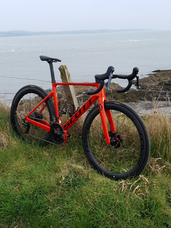

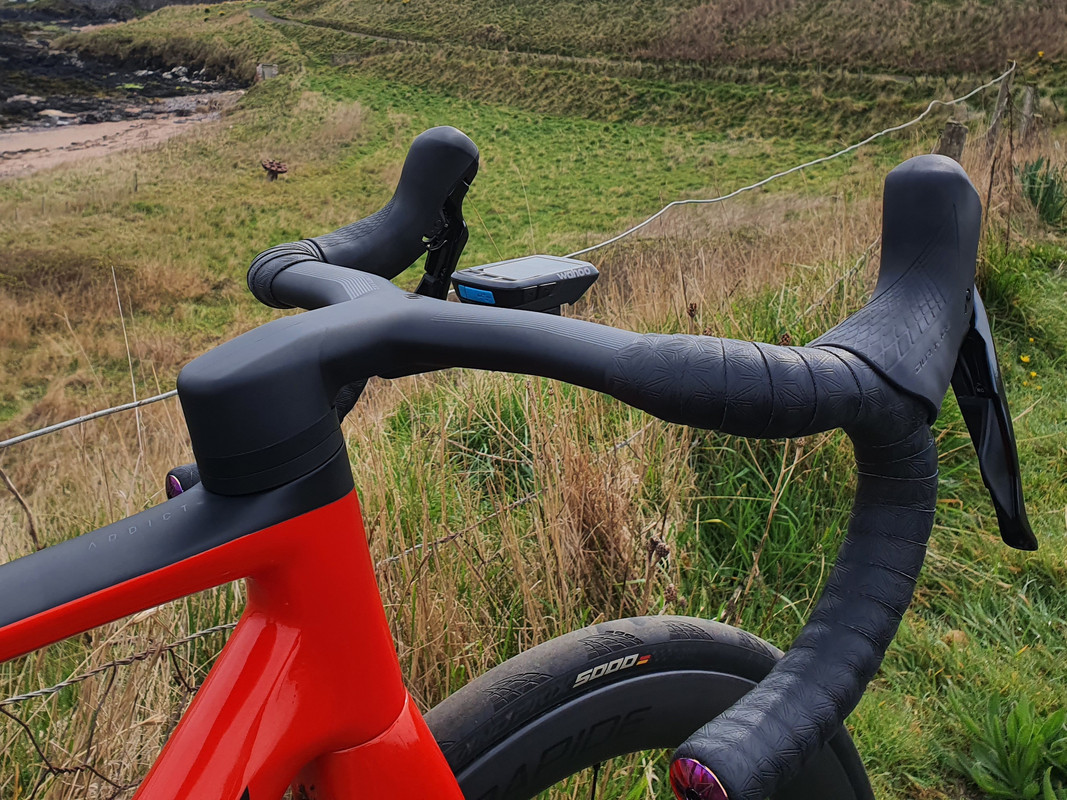

A few pics of mine, after fitting Creston iC SL bars. Reverse wrapped the bar tape for the extra clean look. Really happy with the result and bike has lost nearly 300g from the front end -

Great bartape work! Is it double wrapped on the bottom or not?

Thanks. Its just a single wrap, but I normally wrap with quite close gaps as I like the extra comfort for our knackered roads. There was barely 2" of tape to cut off each end. Good thing about Supacaz is the pattern acts as a guide for getting a uniform wrap.
