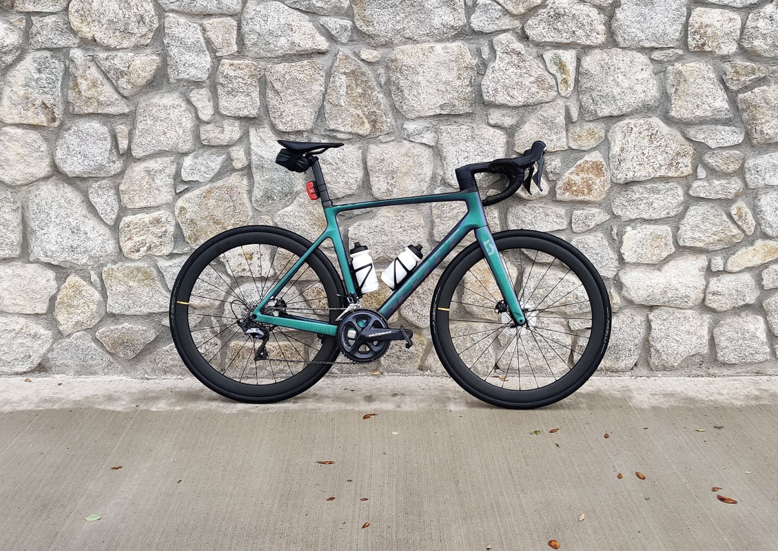

I joined the Addict RC club back in May with my 2021 RC 30 (56cm) with a set of Mavic Cosmic SL 45
It has been flawless until this week when the gear cable to the RD has completely shredded inside the shifter. I noticed poor shifting a few days ago and was unaware at the time the cable was probably frayed in the shifter. When I was pulling to get the slack out of the cable before clamping it back to the RD it must have ripped completely.
So I need to replace this cable (should have gone Di2 from the start ). How easy is this job for a relatively inexperienced home mechanic? I'm comfortable taking off shifters, bar tape, handlebars, stem and headset but I don't have the tools to remove the BB.
Can I simply pull the old inner cable out towards the RD and thread the new cable from the shifter through the outer cable in the frame?

I think there is a complete cable housing through the entire frame, so this should work. (Im not 100% sure on this)CruellaDerailleur wrote: ↑Sat Sep 25, 2021 12:11 am
But if its not too much of a hassle, I would go back to the shop where you bought it. This shouldnt happen after a couple of months and they probably will replace it for free (at least a shop with good service would).
It’s very easy to get the cable through, there is a full length outer housing through the frame and handlebars. The thing that might be most difficult is removing the frayed cable from the shifter. Also when putting a new cable in there make sure you’re shifted all the way to the highest gear (so with the smaller shift paddle) else it gets very fiddly. I do agree the bikeshop will probably do it for you, but it’s faster to do it yourself usually.

Thanks for the tips! I had the bike delivered from another country so I'll give this a go myself. I'm hoping it'll be similar to this video
This will all have to wait a couple of weeks however. I'm in Mallorca for the next 10 days and ironically had already organised a Di2 Ultegra rental. I wanted to see if it was worth upgrading but I think I already know the answer I'll be upgrading to Ultegra R8100 as soon as it's available
