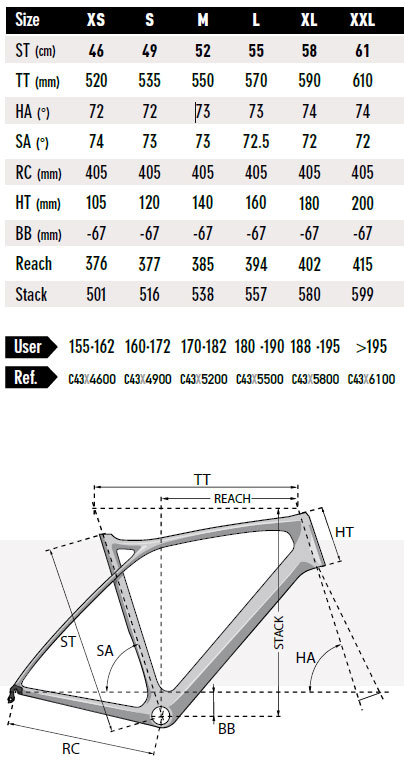

by hfx
Take a look at the Lapierre Xelius, I would say the numbers are quite close to what you're looking..
