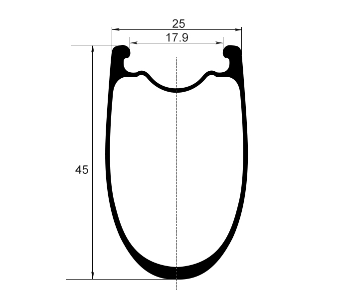

I have trouble to make 25mm GP5000TL air tight on my RRU45C02 LB rim. https://www.lightbicycle.com/45mm-deep- ... rface.html
From the profile it appears to me the hook area is too shallow to lock bead of GP tire. In comparison I have zero issues to make air tight Schwalbe Pro Ones and they have visibly smaller beads. Looks like I will have to sell the tires and get some new Pro Ones, or try something else Hutchinsons maybe..
does anyone have these rims and have a good seal with GP tires?
