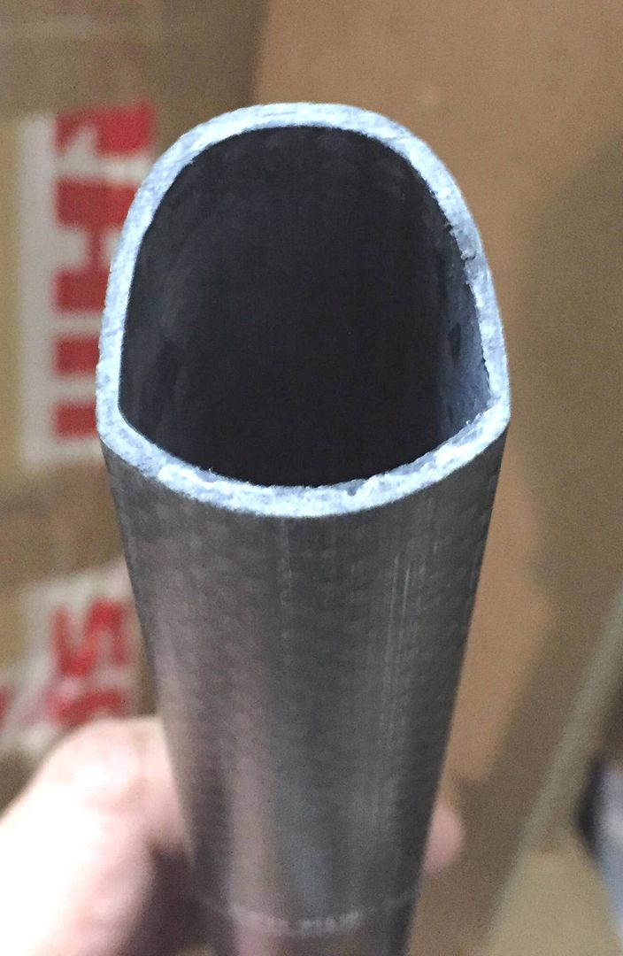

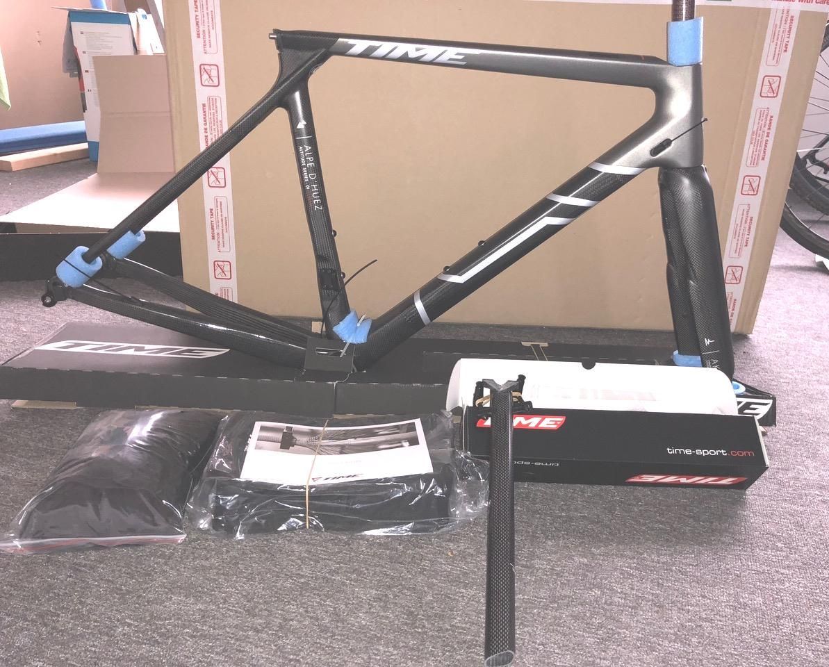

DEADRE
Posts: 42
Joined: Sat Apr 24, 2010 3:20 am
by DEADRE
angrylegs wrote:
Thu Nov 15, 2018 8:46 pm
JKolmo wrote:
Thu Nov 15, 2018 6:45 am
The 01 has a proprietary zero setback seatpost with a unique shape, a one-off item. AFAIK the 21 has a regular 27.2 post though.
Ah wow did not know that. I thought DEADRE was trying to maintain model purity by using only their post, but it's being completely unique and unable to be replaced really surprises me. You'd think they would offer it in a setback version as well.
Below is the shape / images of the seat post from Time.
Regarding the S k c ylone seat post, there is a guy in Ebay, saying / stating, that the seat post from a Cipollini bikes are compatible to the S k c ylone (if it is compatible then, that solves the clamp issue that I have been reading from another Skylone thread & any cyclist fancying this frame but is bothered about the non-setback seat post, then problem solved).
See below link and read up to the bottom of the auction (perhaps someone reading this can attest to this sellers claim) :
https://www.ebay.com/itm/CIPOLLINI-CARB ... rk:16:pf:0
Posts: 7647
Beautiful! Waiting for the final outcome.
BTW I doubt that a Cipollini seatpost is compatible. I used to ride one and I remember it had a different section than the one on my Skylon. I may be wrong though.
