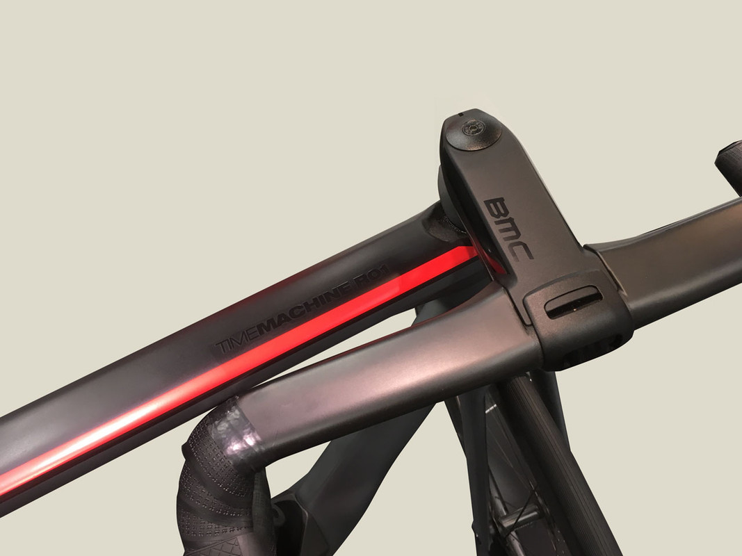

Would there be any issue with the internal cable routing on ICS stem/handlebar to bend like below for travelling purposes?
spdntrxi
Posts: 3115
by spdntrxi
I think that bend is fine.
Ettore
Posts: 101
Joined: Fri Nov 03, 2017 8:44 am
by Ettore
survivor wrote:
Fri Mar 01, 2019 4:50 pm
No, not at all. It should be sized to accept the full range of motion until the bars hit the top tube.

Thanks. Traveling soon and thinking of investing in a Buxum box.
Ettore
Posts: 101
by Ettore
survivor wrote:
Fri Mar 01, 2019 5:11 pm
If it turns out that your stem is too long to fit in that box with the bar attached to it ( doubt it, but it can happen if you have a particularly long stem, like the 130), you can undo the faceplate and the cable cover below the stem, and take the bar off. For security, you can put the faceplate back on the stem, thread the screws in partially, and hang the bar off some zip ties around the screws. This way, you're more free to maneuver the bar into the box.
