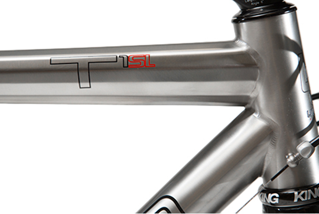

I'm almost certain that all of the tubes on my bike with the exeption of the chainstays were locally ovalized by my builder. I don't know the reason why the DT is ovalized at the HT. I didn't ask for it. Maybe he did it for looks. I'm a small rider and there's really no need for any significant ovalization as the frame is already adequately stiff as is.
Many years ago I once owned a Litespeed Ultimate which had a tear-drop shaped top tube. I foudn the ride extremely stiff and unyielding. Litespeed is known for continuing this tradition in their latest T1SL. Can you think of a reason for such a stiff TT other than for looks?

Specifically for the T1SL, the TT is made out of a rolled sheet of 6.4 Ti, that is supposedly very thin.
The T2 uses standard round & ovalized tube construction:

I don't think any of the main frame tubes add signifigantly to in-plane stiffness unless you're talking about something like a 65cm trapezoid and how well they brace the headtube. For the front triangle on something that is actually somewhat triangular, the maintubes pretty much only need torsional and/or lateral stiffness. ST is mostly lateral because it is resisting being bent out of plane by the BB shell during the power stroke. DT is mostly torsional. TT is a mix.
You could ovalize a TT to be wider than taller, and/or taper it, which you see on a lot of carbon and aluminum frames. These are a lot less common steel and titanium. Sometimes you get things like vertical teardrop TTs which are even sillier than oval TTs. If you want to maximize torsional stiffness of a tube, you want to maximize the area inside the tube, meaning a circle, or the minimum amount of ovalization possible. To maximize lateral stiffness, you want the tube walls as far out to the sides as possible. Sometimes your tubes are already stiff enough. No one rides gaspipe hiten steel frames because they're a lot stiffer.

I agree with 2lo8. I think the TT on the T1SL is overkill. Although I do find that bike to be very sexy! A large TT gives the frame an athletic and racy appearance.
