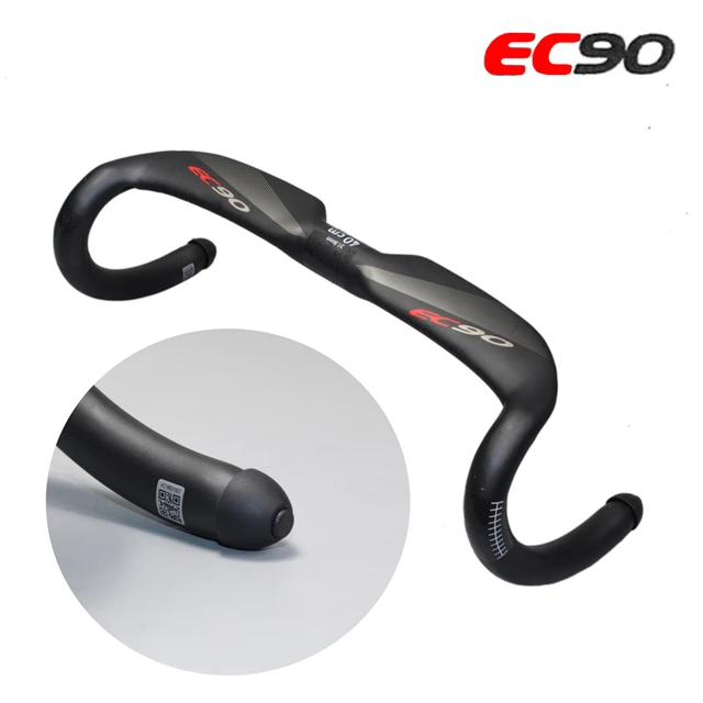

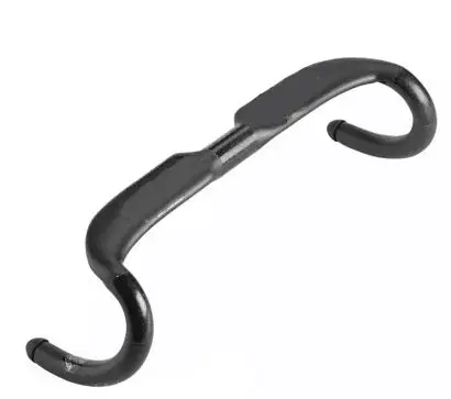

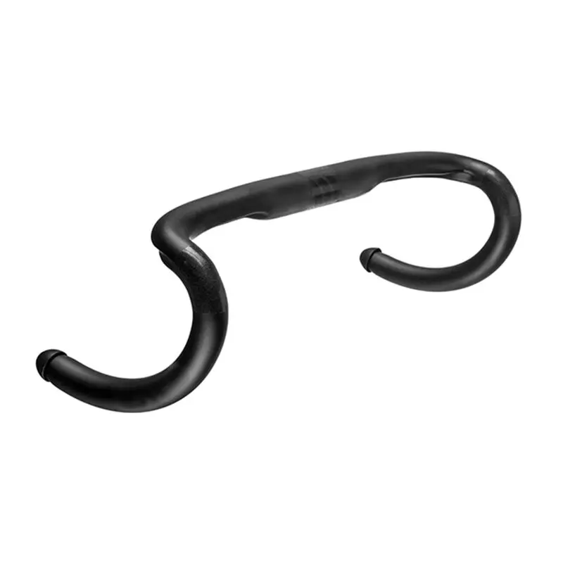

Here's an interesting question though: If you were to actually order those bars, what would you be receiving? A bar that looks exactly like in those photos, or a bar that looks like the photos but with the addition of an Easton logotype?
If you were to order the version of the bars below, I am quite certain they would arrive bearing the Enve logotypes which seem to have been badly removed through Photoshop:

The last bars linked are interesting, in that the photos appear to depict a bar with the "smart bar" bend that I've not seen from anyone other than enve-these bars are much wider in the drops than at the hoods, and enve measure width at drops.
