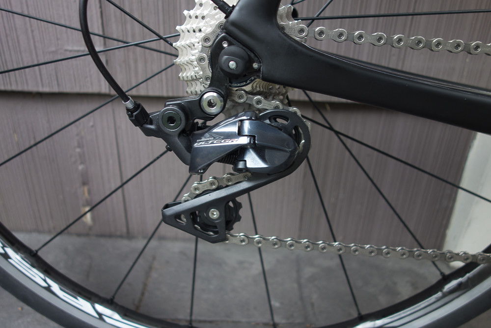

Well gents... played around with the whole mess again today, and can safely say a solution has definitely not been reached. The limiting factor is still how far the body can pivot rearward. When the wheel drops down, it is going to get caught up a bit in the upper pulley. This issue is going to be one of those "it depends" situations. It depends mostly on the combination of the three factors I already listed, which all boils down to the amount of clearance you have between your rear tire and the BB shell. I played with it every which way but Sunday (no, I played with that way too). On both a thru axle disc bike and a rim braked bike with a normal hanger. In both cases the B-link was in play, and I tried to pay particular attention to whether a Direct Mount hanger might make the process easier. The answer was no it wouldn't, at least on these bikes. Where the hangup was occurring was on that last little bit where you're trying to get the cassette clear of the upper pulley. Could it be done... sure... but it is a pain in the ass compared to how things used to be before the Shadow Derailleur.
Here's the setup, Ultegra Shadow derailleur...
Here it is below pulled as far back as the body will go before hitting the stop, and with the cage almost vertical. The vertical cage part is a red herring. If you do the same thing with no wheel in it, the cage will relax but the upper pulley wont't be in much of different place (i.e., this is as far back as it goes). Looks like the wheel should drop right out, and it would with a regular derailleur in it's place which could also be pulled back a lot a more without the stop that prevents doing that with the new derailleur...
And below is the offending obstruction... between the upper pulley and the cassette. The derailleur doesn't want to come back any further, and the BB up front is preventing pushing the wheel any further forward to clear it... you can get it out, but it's tight, and due to the length of the cage, you would do well with a couple of extra hands to simultaneously push and pull and position everything just right in order to get the wheel out. Basically an annoyingly frustrating task, mostly because it used to be so so simple...
Trying to describe it is a bit like one of those "you had to be there" situations... but meanwhile up front... you've got a jam up as well...
I also tried it with the chain positioned on different cogs, but it was always more or less the same thing playing out.

Same as I started with... The new shadow derailleurs may make rear wheel removal more difficult in certain situations with some road bikes. And I can't think of a situation where it would ever be easier (but I'm sure there must be one somewhere) than it would have been with the previous generation Shimano derailleurs, or current Campagnolo, or most likely SRAM (I don't have tons of experience with SRAM, but never hear of people being frustrated removing their rear wheel). And whether or not you have a Direct Mount hanger is simply not the deciding factor. The hanger and frames and dropouts all have to be really designed with the idiosyncracies of the Shadow derailleurs in mind. No wonder Shimano is giving incentives trying to get frame manufacturers to design their frames/dropouts around the new hanger. The pics above show the mechanical drive train, but played with the electric version as well at the beginning and it seemed to be playing the same way, but I need to just check it out again to verify that for certain.

Ok... I just kinda shook my head when I read this... the reason I asked the question in the first place, was because it was beoming painfully obvious to me that you really don't understand this whole setup very well at all. So sorry, but allow me to 'splain a few things...
Firstly, in answer to my question to you a couple of posts ago... No, the B-screw does not affect how far the rear derailleur body can pivot rearwards. It simply adjusts the relationship between the pulley cage and the chain. You can screw that screw all the way in or take it completely out for that matter, but the limiter on how far the rear derailleur can pivot rearwards, is right at the back of the derailleur itself when it comes into contact with the B-link...
In the pic below... see the edge of the B-link that I'm trying to point out with the 2mm Allan wrench...
Good... now I'm going to start with the derailleur in it's relaxed position (below)... see the gap below that edge that I just pointed out...
Ok, now I'm going to pull the derailleur backwards, to close the gap at midpoint or so...
With me so far?... ok then... now I'm going to pull the derailleur body all the way back as far as it can go. It will stop as the body comes in contact with the edge of the B-link... and note the B-screw visible directly underneath it...
You can take that B-screw all the way out or screw it all the way in... it's not going to affect how much further you can pull the derailleur body back. If your chain is too short, I suppose that it would be possible that you could not even pull the derailleur body back far enough to even make contact with the edge of the B-link, but that would be due to a short chain. The point is... the derailleur body cannot be pivoted rearward any further once it comes into contact with the edge of the B-link.
