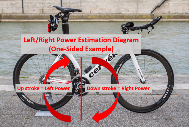

I was going to type something up about this, but DC Rainmaker just addressed this issue in his in-depth review of the P2M NG Eco. So I'll be lazy and cut and paste the pertinent information:
So why don’t I care about left/right power balance (which the ECO lacks)? Well because in the case of how the Power2Max measures it, it’s not real. It’s actually not left/right balance, but rather whether you’re pulling up or not. You can easily trick this by simply single-leg pedaling, and you’ll note the unit totally misses that. Compare this to true left/right balance capable units like the Verve Infocrank, ROTOR 2INPower, PowerTap P1, Garmin Vector, Favero Assioma/Bepro, and so on – which actually measure the left and right sides.

Can someone explain this to me?
What happens, for example, if I were to use platform pedals - would the p2m still not be able to give left/right balance?

sib wrote:Can someone explain this to me?
https://www.dcrainmaker.com/2015/03/the-power2max-type-s-power-meter-in-depth-review.html
"Just for clarity, here’s how it works. It takes your down stroke on (for example) the right side and assumes that all power delivered during that phase is ‘Right only’. Once that occurs, you’re now pressing down on the left side, so it then assumes that all power exerted is coming from the left side. Where this logic falls apart is any up stroke power, which isn’t taken into account for left/right usage (it is in total power of course)."
Acutally it is quite useful to me, I have some muscle imbalance and the P2M shows me wich leg is not working enough.
I hold my feet more vertical on the weak leg and its better.

Bottom line is that P2M measures torque (and hence power) via a single source (strain gauge or whatever) in the spider - hence it has one source of data.
It then determines from which 'side' that torque is being delivered using its cadence measurement (and obviously uses that to get power - i.e. rate of torque).
Having said all that, it's about the only IT/technology device that I've bought in the last 5 years that has been flawless. And the L/R estimation is good enough for me in normal use - yes you can 'trick' it, but why would you want to...?
