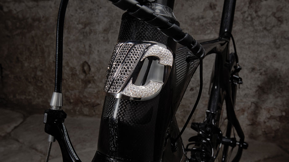

Posts: 6853
Guys are you serious...?
@jwfinesse
See here:
All Cipollini frames are di2 ready. You can clearly see that this hole is intended for electronic transmission. It is just not opened up yet in your frame. Didn't your LBS tell you that? I wonder.
I could accept what you say about the bb but allow me to seriously doubt it...
@RussellS
I guess you are joking unless you cannot understand what design is at all.

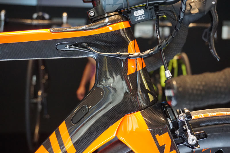

Secondly, that indent there, as I thought, was SUPPOSED to be a electornic wire port, and some NK1K's do use that hole. But guess what? They never drilled it on mine. Even if that hole could be drilled to accommodate Di2, why haven't they drilled it? Cipollini wants end users to drill a 5mm sized hole on a $6,000 carbon frame? and they'd still honor that joke of a warranty, right? All the rest of my frames have EPS charging port pre-drilled and rubber plugged, not to mention some kind of wire port to facilitate Di2 grommet.
Above images I linked are from road.cc Nk1k review and a fellow user on this forum. See how the Di2 cables are set up? I guess their LBS failed to mention the magical port as well.
My NK1K frameset came with Di2 accommodating cable-stop to be used at the same location as images above, at the DS downtube where mechanical cable stop is. So clearly Cipollini's grand plan to use that toptube 'hole' has been scrapped for the frame I bought, and moved on to simply using the mechanical cable stop location. That indent now is a ugly by-product of not thinking the design through, or not changing the mold design even though the intended design has veered off.

kgt wrote:Image
Thanks for posting the picture. It clearly shows there is not one smooth flowing line on the frame. Everything is mashed and scrunched. Who molds those frames to put creases and divots everywhere? Did they wrinkle up the cloth cover before putting it on? Wow.

Posts: 6853
Obviously one can guide the di2 cables throught the top tube or the down tube. It's not that there is one 'correct' way to do it. That's why there are these two options. You see that there is not a hole in the down tube either, just a cover that can be drilled or not. So a toptube or downtube hole is drilled by the LBS only after the rider decides what he prefers. No? What do the instructions following the frame say?
I will not insist on the bb issue I just reacted that way because a design choise was presented as a manufacturing blemish.
