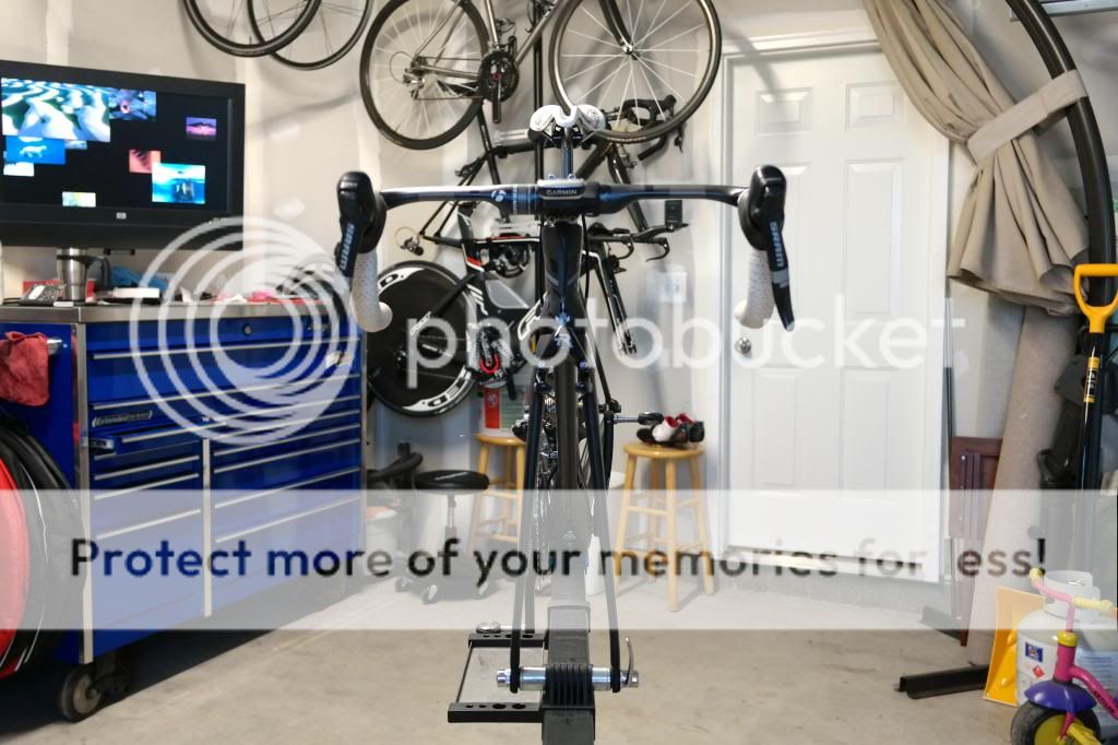

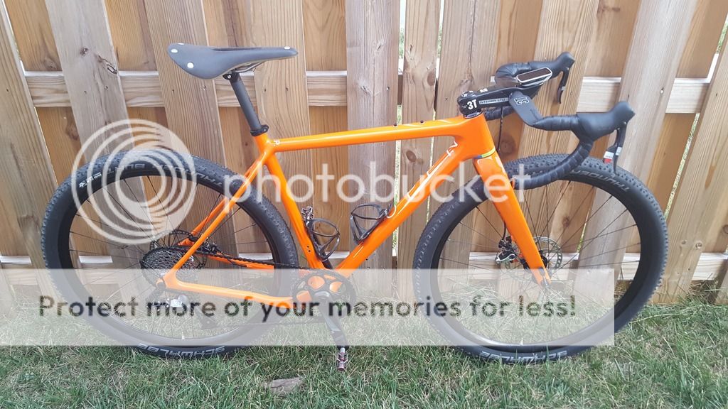

I've used the Bontrager xXx Aero in 38 and quiet liked the feel of their shape and it's one stiff bar. I'm currently on the Aeronova LTD and it's lighter and sleeker looking, IMO. However, it is a little flexy in the chinese ripoff version that someone on eBay passed off as authentic and it also isn't very durable breaking on me during a race. The real Aeronova is nice, however. I just pulled it of my Felt Aero Road and placed it on my U.P. and it's seen every bit of the carnage the fake one did and has come out just fine. In fact, it survived a nasty crash today that sent me to the hospital. As well as one in the Crit at Nationals back in May. It's also a quite bit stiffer; though, I would still give the edge to the Bontrager there. I've also used the Zipp Vuka Sprint, which I liked but wanted something narrower so decided to give the Bonty a shot. The Zipp bar was noticeably flexy, too. I did like the SS setup and found it very comfortable in the drops. The Bontrgar's flare meant my wrist would never hit the tops when sprinting or climbing in the drops. I did notice myself hitting the ripoff 3T when in the drops climbing and sprinting but it's shape is slightly different than the real version.
The bontrager width is measured at the hoods, the 3T's are at the end of the drops, and I am unsure of Zipps method, but believe it is at the hood.
To surmise:
– Bontrager is the stiffest of the four bars I've tried. However, aesthetics and branding might not work with what you have.
– Chinese 3T Aeronova (I can give you the username of the eBay individual so you can steer clear) flexy, heavy, and fragile.
– Genuine 3T Aeronova light, comfy, strong, and the reach isn't as big a deal as the number suggest. Interestingly, you work out with two "hoods" position. Best looking aerobar out there.
– Zipp VukaSprint Nice bar but nothing stood out: not the lightest, not the stiffest, and not the most comfortable.

Included some photos so you can see it on both road bikes, as well as the Bonty for comparison.
Any how. Lesson learned and I will pay a little more to ensure I get the real thing in the future. The real Aeronova LTD is quite nice and I highly recommend it. If you are comfortable with your reach now and still jump on the rivet when hammering I think you will be okay in that regard. And the looks....is there anything else out that looks better? The Ritchey integrated unit looks nice and is light as well.....maybe that guy if I had it to do over again.
