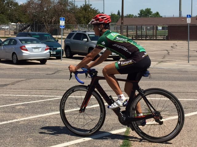

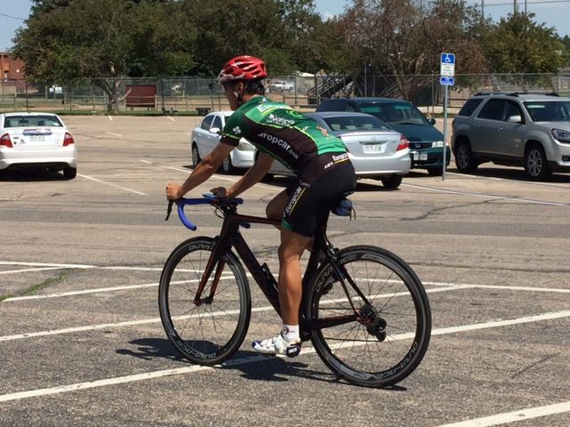

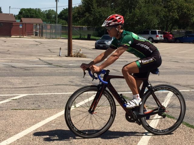

Thanks guys for the comments. Today I asked my kids to take some photos of me on the bike. I' sort of an 'old school' and I didn't do much research or reading when I got my bike. Here are my stats. I'm 5' 7-1/2" (171.5cm) tall with an inseam of 30" (76cm). I'm riding a 54cm bike (effective top tube = 54.5cm) with a 100mm stem. When my bike speed is high I usually keep my hands on the hoods but I bend my elbows more in order to get lower. I didn't show this position in the photo shoot. If I ride in the drops I find my elbows are locked. By keeping my hands on the hoods and elbows bent I think I can get quite low while minimizing the frontal area as compared to having my hands in the drops. Based on the pictures what you guys think of my bike fit? I have the impression that I'm riding a frame that's one size too large. The next smallest size is a 52cm with an effective top-tube length of 53cm.

I think you meant 5'7" not 6'7".
Your arms seem to be pretty far extended, nearly locking your elbows, which would cause hand numbness and pain.
Depending on your flexibility and comfort, can you rotate your hips forward you may be able to bend your elbows more due to being able to straighten your back.
Holding the tops of the hoods would seem to not terribly comfortable due to the long reach.

You def. need a shorter stem or headtube.

Whats your saddle tip to bar center?
