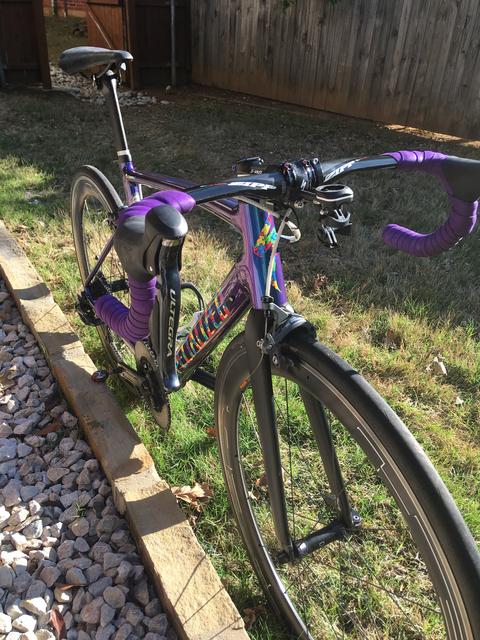

by IrrelevantD on Tue Apr 09, 2019 1:48 am
Never was a huge fan of the matte black logo and letering. Decided it was time to personalize it. My wife got a Cricut, so I borrowed it and got some vinyl that was a little more personal to my family.
(please ignore the lack of proper valve stem placement and dirty chainring)
* There is a 70% chance that what you have just read has a peppering of cynicism or sarcasm and generally should not be taken seriously.
I'll leave it up to you to figure out the other 30%. If you are in any way offended, that's on you.
