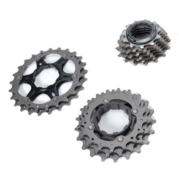

TheDarkInstall wrote:Very late, I know, but I have found the source of the creaking that loads of people get, and fixed it.
This will be applicable to the new 9100 cassette too, to I thought it worth posting.
So, here it is...
The creaking comes from the top two largest cogs, which are mounted to a metal carrier with 6 rivets. The rivets are where the creaking comes from.
To fix this, you simply need to lube/oil each one of these rivets. I use Silicone lubricant out of a spray can with a thin nozzle to accurately spray each rivet. I do this about once a week, and I have not had a single creak out of the cassette since starting this. Previously, I was getting a massive spring like creaking sound which was both extremely annoying and had me worried that something was about to snap!
Looking at the rivets, on a cassette that has been ridden (and specifically, which has been climbed hard in low gears), you can see each rivet is slightly offset where the two cogs have shifted with the force of the chain.
So there you go.

I disagree that the creaking comes from the rivets. The cassette will creak on pretty much all cogs. I think I found a solution, though. Evidently, on many freehubs the CS-9000 will not fully cinch down in stock form. If you pinch the largest cog and move it horizontally, you will notice a tiny bit of play. This leads to the creaking!
My solution is simple: add a shim or two to the locknut, which compresses the cogs fully and eliminates the play. I used old Shimano washers from other 11sp locknuts. Works like a charm. Figured this out today after installing a brand new DA cassette on my C24 9000 wheel.

Asteroid wrote:I disagree that the creaking comes from the rivets. The cassette will creak on pretty much all cogs. I think I found a solution, though. Evidently, on many freehubs the CS-9000 will not fully cinch down in stock form. If you pinch the largest cog and move it horizontally, you will notice a tiny bit of play. This leads to the creaking!
It absolutely is the rivets.
Your observations prove this; the 'horizontal' movement you are feeling is not due to the freebody being too long for the cassette, rather it is exactly the play in the rivets on the largest two cogs I was talking about. It is not due to the freebody being too long. I have never seen a freebody that is too long to allow for the cassette to be tightened down hard, especially from Shimano!
I have more info on this which I found the other day. Will be making a video on this when I get the chance, but to summarise;
Taking the cassette off, and holding the top two cogs section, you can feel play in the rivets by twisting the cogs against eachother with your hands. On cassettes that have a lot of kms on them, you can actually see the moving with your eyes.
TheDarkInstall
Posts: 723
Joined: Sun Jan 26, 2014 3:44 am
by TheDarkInstall
Right, here you go...
https://www.youtube.com/watch?v=TDnCj-LQpf0
Play in the rivets. This cassette is not even that old. I have been through 4 DA9000 cassettes now, and they all do this... So as well as the composite carrier cracking apart, the rivets are also shoddy.

Well, you posted a nice little video showing some cog movement, but your logic is flawed. Moreover, you did not closely read what I said. And, yes, before putting a brand spankin new cassette on my WH-9000 C24's (recently repacked hubs, in fact), I sprayed lubricant on the rivets on the two carriers to no avail.
With that non-working solution in mind, follow my method to isolate:
1. Experienced creaking in ALL gears, when putting decent pressure on the pedals.
2. Noticed lateral movement of cassette. This applies to the entire set of 11 cogs, incidentally.
3. Removed locknut and inserted two extra washers.
4. Tightened locknut to proper torque setting.
5. Observed lateral movement eliminated entirely.
6. No more creaking in any gears.
I might go on to surmise that the tiny bit of play could lead to the 2nd carrier failures posted here. Oddly enough, I do not recall anybody posting pics of the first carrier rivets failing. Your results may vary.

You've done something wrong if your cassette moves laterally on a 9000 hub. As for putting on 2mm of extra spacers, you'd be lucky to get the lock ring to engage. I think there is something wrong with your freehub.

I agree with Petal666.
If you need to put spacers into the system for it to tighten adequately, when a Shimano cassette is being used on a Shimano hub, there is something not right.
Appreciate the break-down of the issue you are having, Asteroid, despite your edgy tone...
Any chance you can make a video of your issue happening?
Also, as you say this happens on a variety of hubs, which hubs are you specifically referring to? If the same cassette is having issues across a variety of hubs, there is something wrong with the cassette, or your installation.
As for nobody posting pictures of the first carrier rivets failing; the composite carrier suffers catastrophic failure, whereas the failure in the first carrier manifests itself in creaking and play. Less obvious, or noticeable to a lot of people, especially those not putting enough torque through the first carrier to start it creaking (ie, people not doing a lot of steep climbing).

The first carrier is alloy. The catastrophic failures only occur on the second carrier.
