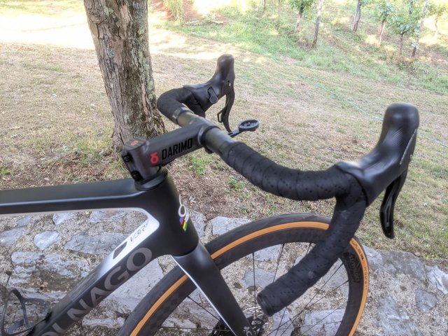

What stem is everyone using? I have the Sr9 stem with R41 bars and need a longer stem. Any alternatives (lighter) than the SR9 that still integrates the cables?
sgergole
Posts: 46
Joined: Fri Mar 18, 2016 11:39 am
by sgergole
Perp wrote:
Fri Aug 13, 2021 6:35 pm
I integrated everything with Darimo stem and handlebars. It wasn't easy to set it up though.
milanv
Posts: 180
Joined: Wed Mar 10, 2021 9:03 am
by milanv
sgergole wrote:
Wed Aug 18, 2021 9:58 am
Pics, more information?

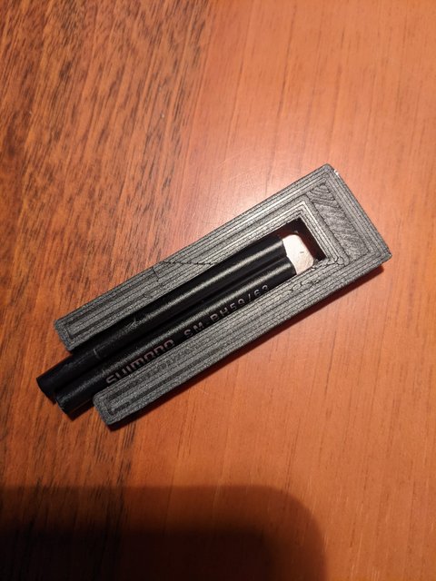

sgergole
Posts: 46
by sgergole
chazman wrote:
Thu Aug 26, 2021 7:52 pm
Hi, you mentioned the carbon reinforcement that you drilled, did that come with the stem? Or did the red plastic reinforcement come with the stem? I've seen the SR9 stem kit includes a metal reinforcement but I could have remembered it incorrectly...
It has the same shape as the red plastic reinforcement, but it is made of carbon and supplied by Darimo with the stem. I had to adapt it since I needed 3x cables to pass in it, and it was just not wide enough
sgergole
Posts: 46
by sgergole
milanv wrote:
Wed Aug 18, 2021 10:13 am
there we go with the final result. For some complicated reasons I had to mount again the standard SR9, but will put back the Darimo as soon as possible, even if it takes 4 hours of effort to do it again and a lot of swearing. it just looks too good to me.
