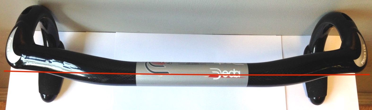

I'm looking for a carbon handlebar that is set forward. Would really appreciate it, if you can tell me the brand and model that is currently available out in the market. Thank you all!
Just as an example, below is the Deda Phazer, (unfortunelty this model is not longer available) as you can see from the veiw from the top, the portion of the shifter placement / drops is forwarded about 1inches or 2.6 cm from the stem clamp.

Why not get a handlebar with long reach? For example, the 3T Aerotundo has a reach of 113 mm, which is ~3-4 cm longer than what you typically find these days.

Vision 4d or 5d?
