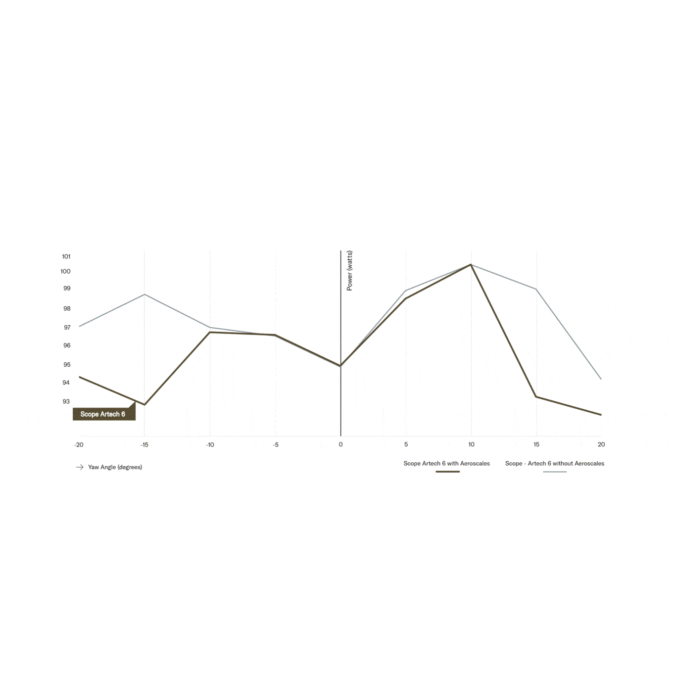

Here is a question I have. Some of the deeper wheels (more so than others) exhibit a marked stalling behavior at high yaw angles - Scope, Vision Metron, Enve 6.7. being examples of this. Pretty clear that this is highly correlated to the wheel depth, but again, not every deep wheel is the same in this regard; shape seems to matters too - e.g., PCW 6560, which is also very deep, has a lot less of this stall at high yaw.
So which wheel would be more stable in cross winds (which is when these high yaw angles happen)? E.g., will Scope be more stable than PCW or will it be the other way around? Does anyone know?

aeroisnteverything wrote: ↑Thu Nov 28, 2024 12:36 pmHere is a question I have. Some of the deeper wheels (more so than others) exhibit a marked stalling behavior at high yaw angles - Scope, Vision Metron, Enve 6.7. being examples of this. Pretty clear that this is highly correlated to the wheel depth, but again, not every deep wheel is the same in this regard; shape seems to matters too - e.g., PCW 6560, which is also very deep, has a lot less of this stall at high yaw.
What toxin said. The Scope, Vision, Enve, Syncros, Reserve, Parcours, etc. all had lower CdA beyond 15deg yaw vs at 15deg. The Black Inc, Princeton, SwissSide, Campagnolo, Roval and Scribe wheels all show evidence of stall beyond 15deg as their CdA ticked up.
Delayed stall is one predictor of improved control in crosswinds, but it’s not the only one.
I think you are mis-reading the chart. The test was only run to 15deg of yaw so we don't know how any wheels that we tested perform at higher yaw angles. The screenshot posted by Jaisen has leader lines to help identify each line on the chart. These are not data points!TobinHatesYou wrote: ↑Thu Nov 28, 2024 4:05 pmThe Scope, Vision, Enve, Syncros, Reserve, Parcours, etc. all had lower CdA beyond 15deg yaw vs at 15deg. The Black Inc, Princeton, SwissSide, Campagnolo, Roval and Scribe wheels all show evidence of stall beyond 15deg as their CdA ticked up.

There's no doubt Scope have done a good job, but the advantage of any wheel is slight before you reach the 10-15 degree band, and here Scope's advantage becomes clearer. As part of this the Scope fish scales tech is very interesting, but expensive (£4,000 wheels once you throw in ceramic bearings). Like a real fish, the size and placement of the scales may well allow tuning to a target environment. Scope's own graph (https://www.scopecycling.com/wp-content ... 6x1366.gif) strongly suggests the scales were tuned to improve performance between 10 and 15 degrees, when compared to rims w/o scales. But at both 10 and 20 degrees the two solutions are not that different. There are often competing claims about yaw angles in the real world, but Flo performed a credible analysis (https://blog.flocycling.com/aero-wheels ... lection-1/) that showed 80% of riding yaw was below 10 degrees, 14% was 10-15 degrees, and 7% was 15-20%. So in reviewing CN's +/-15 degree graphs, the significant part of the Scope advantage will apply to 14% of your ride. Scope's graph shows an advantage of 6W at 15 degrees and 0W at 10 degrees. So an average 3W advantage across the 10-15 degree band. That's a credible 3W advantage over 15% of your ride, but it does come at quite a price.
CN's tests didn't reach 20 degrees, but Scope's graph shows a 3W average saving from 10 to 20 degrees, which is (14%+7%=) 21% of your ride. However, averaging out 3W x 21% over a whole ride gives just 0.6W saving per ride, which might be less of a real-world benefit than CN's graphs might initially suggest.
