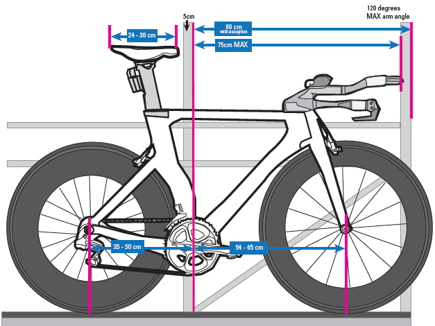

I had no intention of upgrading the stock 105 derailleurs and DA shifters. But after I changed my arm/hand position with the 50 degree extensions, the shifter measured 14cm from armrest in its most vertical position (ie shifted into largest rear sprocket ). Even though you’d almost never be in that gear (especially when racing), and your hands would be lower as you’d definitely not be holding only the top of the shift lever, I wanted to make sure to stay within 10cm (UCI reg).
Sticking with the extensions meant either DI 2 or SRAM (or campag) r2c-style shifters which you ‘lock’ into their highest rested position. Since this was supposed to be a ‘budget’ TT bike I ended up with the cheapest option - SRAM. I then had to move the extensions 1.5cm back to stay within the 80cm rule. In the end a slightly compromised position but until I gain 40 watts at threshold I will finish 3 minutes down on Tinea Pedis anyway...

@NickJHP I agree with the others. There's something wrong with your position in order to minimize your frontal aera. And I cant imagine, that you position agrees with the UCI 75 cm saddle to bars rule.
I know it's not fair to compare with Toms textbook position on a tt bike. But look how the back of his helmet is flush with his back. It doesn't get any more aero. And the helmet makes for a huge amount of drag, if it's not hidden away.
