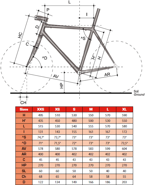

Another fit question guys. I've decided to buy ADH01 disc for my next framset. I own 2009 RXR size XS ETT=53.5 and also 2012 NXR in Small ETT=54cm. Its a 1/2 cm difference but both bikes have different geometry.
Looks like Time changed the seatpost setback from what I am used to. I see from posts and pics online that 2018 ADH01 had a vertical bar to move saddle a bit forward and back. 2019 (at least the disc model) seems to gone back to fixed post saddle attachment with a slight setback.
The XS RXR fits me perfect with my SI SLR flow carbonio saddle rails centered middle of the post. I can ride small NXR but I feel more strecthed out on the hoods. Both bikes have same model 100mm Time stem and same saddle.
I am reading here on some posts that should go up a size but I don't want to make an expensive mistake with resale price of these being not great. I like these bikes and they don't beat me up on multi day 100+ mile rides. Most important thing is if my fit is slightly off then I can't ride due to old achilles and IT band injuries coming back(funny how few mms makes a difference).
I will post my current saddle setup and saddle height height later. For those who had an RXR or NXR and own one of the new Time frames; did you end up going up a size for ADH or even a Scylon which seems to have same geometry?

Posts: 8654
I have not ridden either NXR or RXR but looking at the geometries and judging from your pictures I would suggest you go for size XS. The geometry of an XS Alpe d' Huez will be better IMHO. You will only have to use a longer than 100mm stem.
RXR
NXR
AdH

by JCrider
Thanks kgt. I think you are right. Looks like Time is measuring the effective top tube from front of the seat tube now vs. center of the seat tube in the past. Although NXR geometry looks same in terms of numbers TT would be slightly longer on the newer frames. Found this pic online which shows that the 2019 disc AdH saddle adapter is now slightly setback.
Skewers are now 12mm from the pic. Curious what is the max tire size that can be used on this frame.

by Calnago
You really can’t be comparing their current “effective top tube” length to anything. Or their seat tube angle. Or their seatpost setback. Because their published seattube angle relates to nothing real, the actual seat tube angle is much slacker than what’s published, it just creates a confusing mess for people that know geometry and really are looking closely at that stuff to ensure everything is where it’s expected to be once all built up. If the extra small fit you in the older version, you probably will be fine with an extra small in the current version. However, due to the design of the seat clamp, there is significantly less fore/aft saddle adjustment available than had it been a more standard type of clamp.
So, assuming you get your fit right, taking what you said about liking the “all day comfort” of say, an RXR, you will be in for quite a shock with something like a Skylon, as I’ve had some time on a RXR Ulteam (noodle) and a lot of time on the newer Skylon. I found the RXR Ulteam very soft and noodle like and would not want to be in the mountains with it, so unlike you I would much prefer the Skylons stiffness. However, the Skylon is a noticeably harsh ride. I know you’re looking at the Adh but they share the same geometry. Hopefully the Adh is not as harsh, but hopefully it’s not a noodle either. In your favor in that regard, if it does lean toward the lighter and more noodly side of things, the fact that your on a smaller frame will help.
