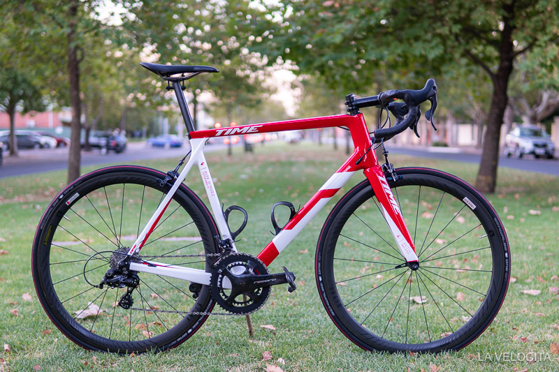

Since I do not intend to argue any more stating the obvious... a nice, recent review of Time Alpe d'Huez:
https://www.lavelocita.cc/la-velocita-r ... -01-review
My experience of the frame is very close to his.
