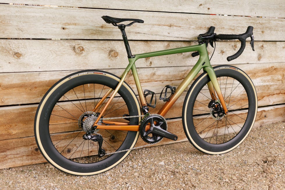

kitchencity
Posts: 3
Joined: Thu Jun 24, 2021 9:06 pm
by kitchencity
21 custom paint with ultegra 8100...
Is the RTP option a new thing or have Time offered this previously?
