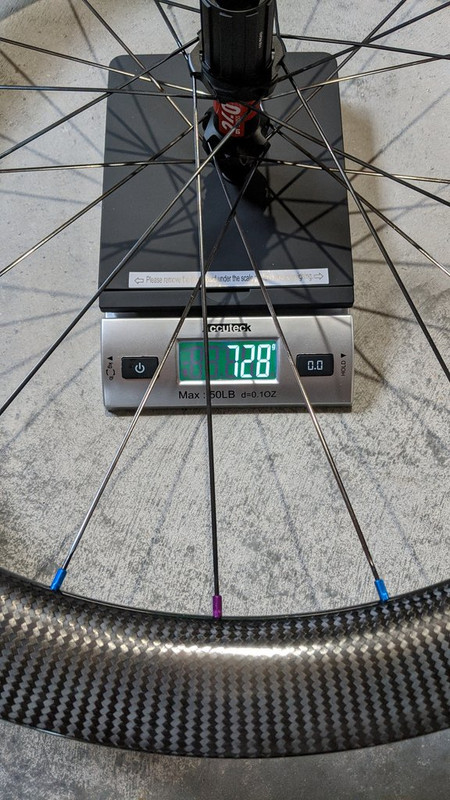

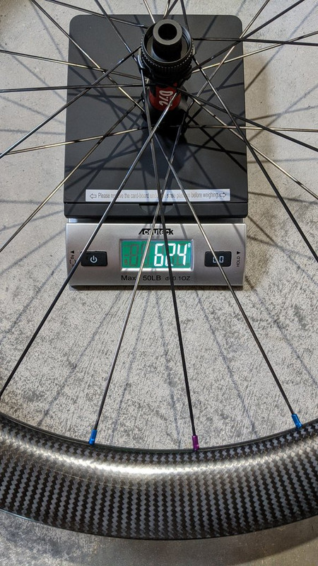

Happy much-belated birthday to me. Ordered placed on June 15th, wheels arrived from China on August 3rd w/ FedEx shipping. WR50s with flyweight carbon and a bit of bling-bling 'cause we all know that a bit of bling makes you (psychologically) faster 8)

PoorInRichfield wrote:
Tue Aug 04, 2020 1:05 am
These look good!
Nice weight too!
I'm desperatly waiting on the WR38 flyweight rims I ordered on June 16th, but they are still in "processing" :(
