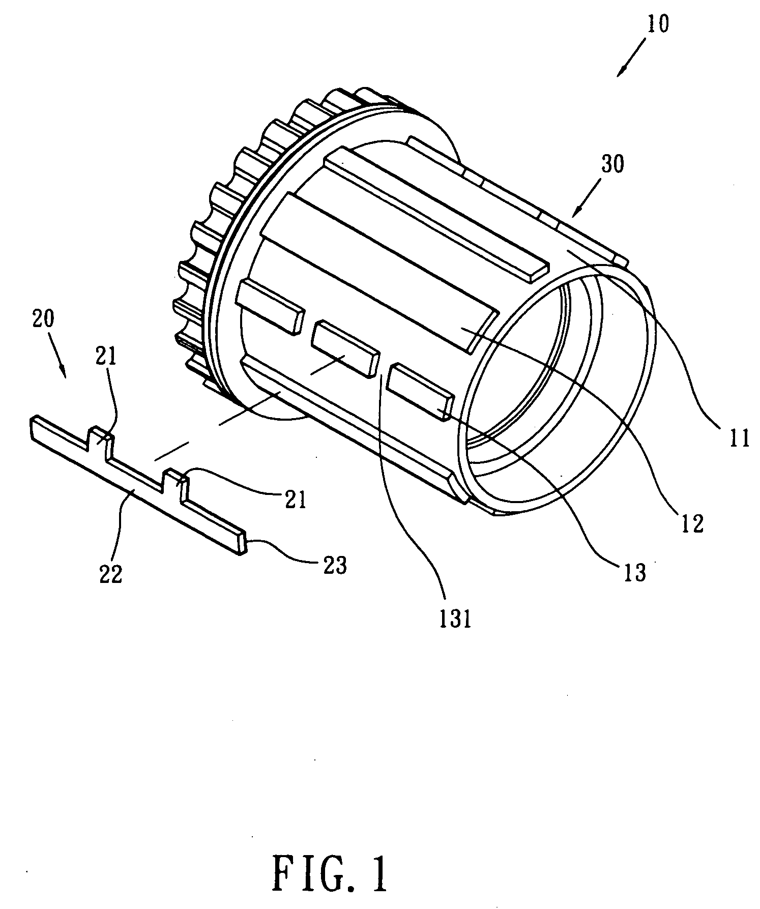

Joking aside Bill Shook of the now defunct American Classic has a patent on an aluminum freehub with a steel insert. Some companies are using this design. Maybe they licensed it from Bill.
I used to use the Sram cassette but now I've gone with a big cassette (Ultegra 11-34) and I'm now seeing the same problem on my alu freehub.
https://www.google.com/patents/US20080315679

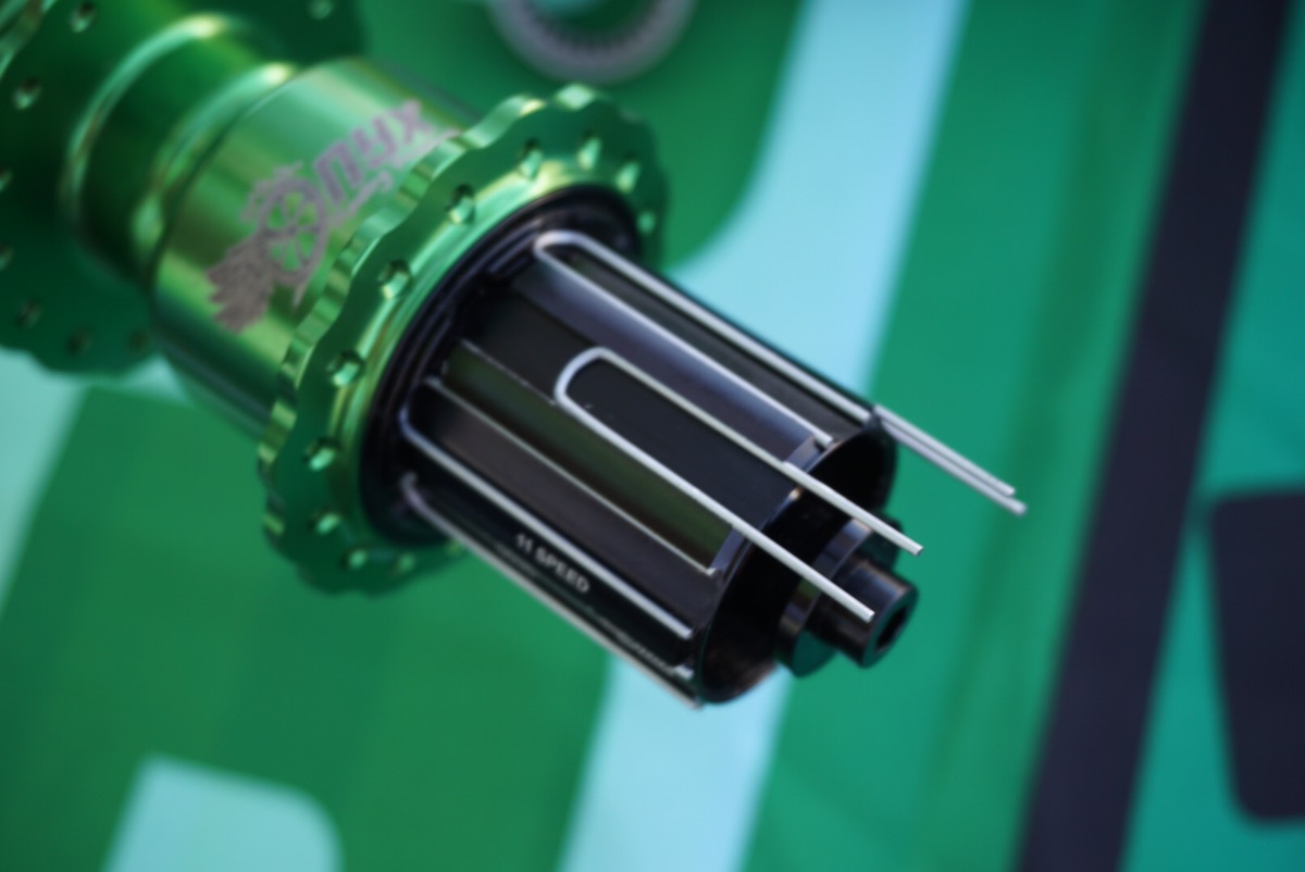

google industrial staples freehub body damage.
a charm
http://huckingkitty.com/forums/viewtopic.php?f=12&t=68
actually used it to run 8spd campag sprockets-cassette on a 10 spd hub..
