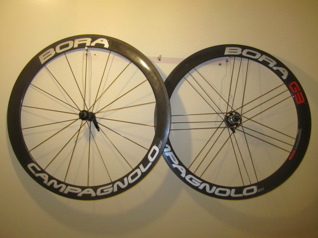

History of the Bora wheelset:
1st Gen. : Alu / Carbon rim - Alu Record hubs - Tubular ca 1998 :
2 nd Gen. : Bora G3 - Carbon Rim - Alu Record Hub - Tubular - just One version ca 1999 - 2003 :
3 rd Gen. : Bora G3 - Carbon Rim - Alu Black Hub - Tubular ca 2004 - 2008 :
4 th Gen. : Bora Ultra - Carbon rim - Carbon Hub - Tubular - Plain stickers not 3D 2007 - 2009 :
5 th Gen. : Bora Ultra Two - Carbon rim en Hubs - Tubular - 1st series 3D decals & Bora One Carbon rim - alu hubs - tubular ca 2010-2012 :
6 th Gen. : Bora Ultra two and Bora One - Tubular - Weight balancing in the rim instead of balancing spokes - 2nd Gen. of 3D decals 2011-2014 :
7th Gen. : Campagnolo Bora Ultra 50 / 35 and Bora One 50 / 35 ; Tubular and clincher versions - For the Ultra Carbon hubs and for the One's Alu hubs - New wider rim 24,5mm and diamond brake surface - spoke nipples not internal anymore but servicable without removing tubulars.
