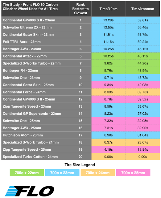

23mm tires will be at scarcity in 2-3 years as the industry is going at full speed to increase tire clearance on all road bikes. 28mm is becoming the standard. With wider tires you can run lower pressure, increase comfort, increase traction and improve rolling resistance. Many would argue that 23mm is the aero king. Sure, that's because external width of any modern rim is between 24-27mm and isn't optimized for 25mm tires. Enve is the first one to push this out to ~30mm. Long story short, there's a delta of ~4.5 seconds (see #1 and #12 in the chart below) in 40k if you race and want every advantage, then 23mm is for you.
Source: http://flocycling.blogspot.com/2016/04/ ... study.html
