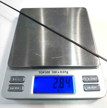

Sorry only just received spokes and sent off wheels to get built. End of next week I may be able to respond.
weight wise they came in pretty accurate, just a shame the nipples are heavy 0.4g and of such limited choice size and maunfactures wise. They are comparible weight wise to the Berds by the time you add in all the extra little bits and pieces needed witht the Berds. I like Klaster1 am small and lightweight and I prefered the look and easier build over the Berds for this build at least.
I got my spokes from Topventure at the Vaxes reduced price $7.50, so I think similar to what Klaster paid. Didn't appreciate the Paypal fee and the steep shipping charges though.
278mm and 266mm spokes.
Image Image
