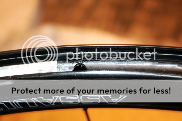

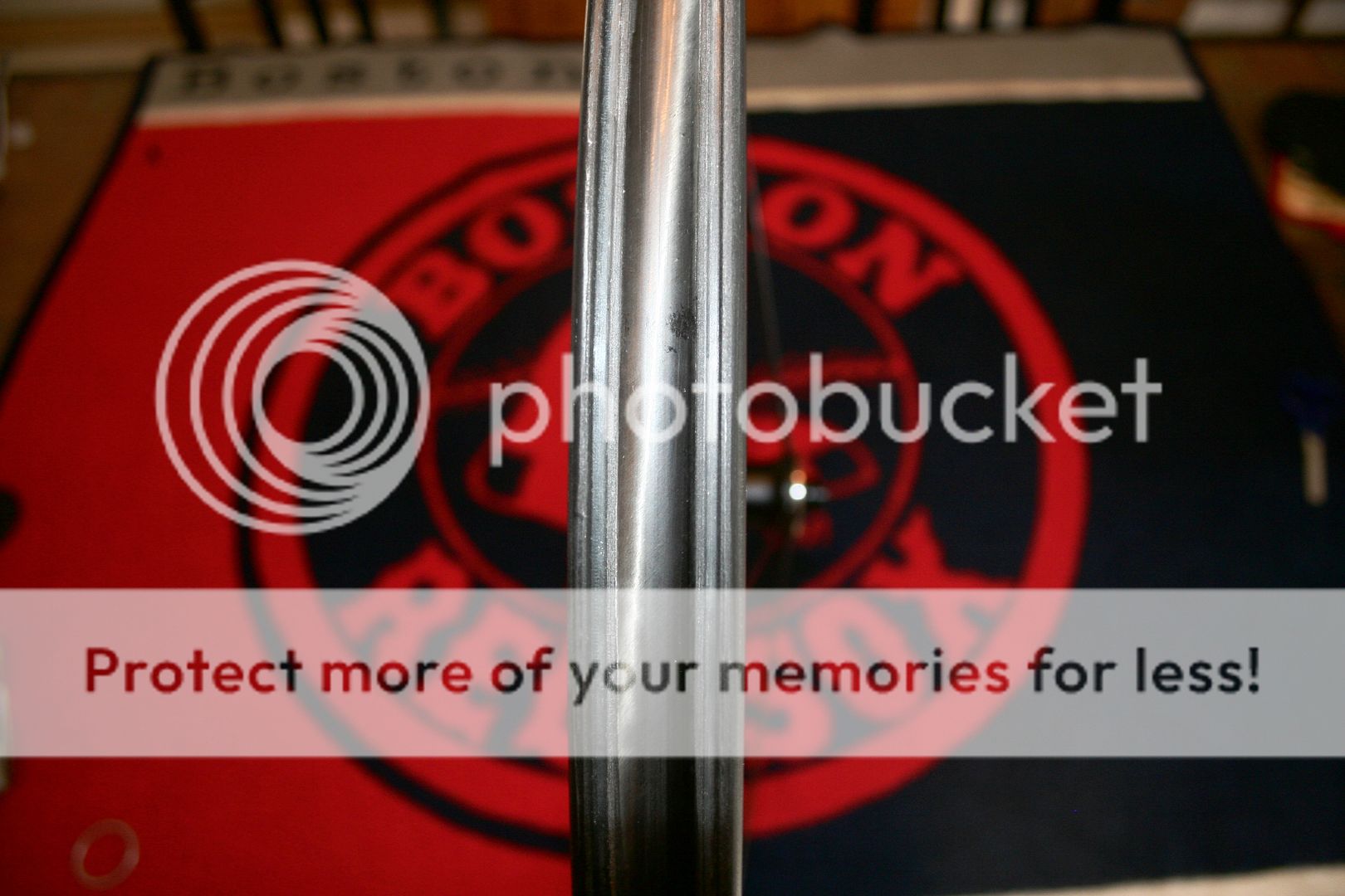

I had a really bad experience with the tubeless Assaults and I'll explain in detail what happened, sorry for the long post. For background, I've been riding road tubeless for the last 3-4 years mostly on a set of Ultegra 6700 wheels using several different tires like the Fusion 3's, Schwalbe One's, and now the Pro One's without any issues whatsoever related to the components of a tubeless tire system. I give credit to the fact that the Ultegra wheels are a certified road tubeless rim design where the rim is designed not only to help inflate the tire with a specially designed center channel, it also has a special bead design with a contour that will lock the bead in place which will help keep the tire on the rim in the event of a sudden flat giving the rider time to stop before damaging the rim, and most importantly a solid center channel with no spoke holes thus no need for rim tape.
The problem I had with the Assaults was the rim channel where the tape adheres to the rim. It was so uneven wherever there was a seam that it left little gaps where air would escape under the tape, through the spoke access holes, into the hollow rim cavity, and finally out through the point of least resistance which is the base of the valve stem. I first thought it was a valve stem issue because that's where it was leaking and tried a few different brands plus ruined one by over tightening it. The leak was internal at 180 degrees opposite of the stem and you could actually hear it leak inside. Another thing to note with a hollow carbon rim is that if air can get under the tape so can the sealant and just imaging getting a nice dried lump of latex rolling around inside your new wheels?
Sounds silly doesn't it? Easy fix right? That's what I thought and so did my local bike shop who sold me the wheels but after re-taping the first set a few times with no remedy and receiving a second set from Reynolds under warranty that were worse than the first set I threw in the towel, returned them and bought a set of Easton EC90SL's which are a true "Certified Road Tubeless" wheelset. I mounted my tires and have been riding them trouble free since November.
I'm sure as a std clincher setup the Reynolds wheels are just fine but as tubeless, you'd better go into the purchase expecting to have some issues. The Easton's I bought were a bit more money but worth every penny to not have to worry about what's going on inside my wheels as I ride. If I couldn't afford a Certified Road Tubeless set of Carbon Clinchers, I'd go lightweight aluminum. That way there's no hollow cavity and a smooth surface for the tape to do its job. Here's a few pics of my problem wheels, if you look close you can see the imperfections just above the spoke hole. The bottom picture is my Easton EC90SL with no spoke holes. As far as I know they are the only big name wheel manufacturer making them this way.

Thanks for the replies. I'm afraid the No Tubes and Easton wheels are a bit too pricey for me and don't address the issue of rim width compatibility with my Pacentis. Current carbons are 3.5mm narrower, going to a 28mm carbon rim would leave my Pacentis 4mm short.
The rim finishing certainly does look an issue on the photos. I guess the best I can do with that, if I do go for Reynolds wheels is to get the supplier to check over before shipping.

I'm not running tubeless, but have a set of Strike SLG. I can confirm, that rim tape they have, and the rim bed/channel, is nothing I would rely upon, especially since it still has spoke holes in the rim bed?!?!
Easy to see why a tubeless setup wouldn't work worth beans on these. I personally just run velo plugs and butyl tubes and GP4000S II tires. So no worries.
Agreed on the Reynolds, the design and thought of the tape over spoke holes in the rim, don't see how that would work out well at all.

SgtRock wrote:The rim finishing certainly does look an issue on the photos. I guess the best I can do with that, if I do go for Reynolds wheels is to get the supplier to check over before shipping.
Not only did I send my Assaults back to Reynolds, they said they saw the problem and sent me a replacement set that was just as bad if not worse than the first. Their response after I contacted them about the replacement set was "we've never experienced the issue you described, that's just the way they're made". At that point I knew I was screwed so I brought them right back to the shop I bought them from and although by this time it was 3 months later the shop owner was gracious enough to give me credit to purchase something else. Do as you wish but if tubeless is what you're after, I'd look elsewhere.
