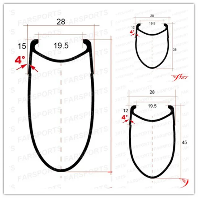

AJS914
Posts: 3463
by AJS914
Farsports new 45mm rim seems to be pretty close to a Zipp 303. The next step up from 45 is 58mm - just like the Zipp 404. With this kind of shape, do people think that a 58mm rim is easily handled in a group ride?

by ubers
AJS914 wrote:
Tue Oct 23, 2018 4:38 am
If you are going to be training on it, I would recommend the 45mm deep rim. Strong cross winds this won't push you around as much as the 58mm rim.
Have you considered getting a 28mm wide front rim and 25mm rear? I'm sure your colnago will accommodate that width. With a 25mm tire, the wider front rim will give you a flush rim/tire transition that will be more aero at a wider range of yaw angles.

by AJS914
What does a narrower rim on the rear achieve? Lighter?
Do 58mm wheels push one around? I'm most concerned about group rides. We see pros ride 404s all the time. They don't seem to have a problem.

by ubers
AJS914 wrote:
Thu Oct 25, 2018 1:45 am
I suggested narrower on the rear because i thought you had clearance issues with the colnago.
I ride 60mm front enves, and i get pushed around in strong cross winds. Not sure if pros have a problem with deep wheels, i've never ridden with them.

by AJS914
Maybe 45 is the way to go.
The primary clearance issue on the C59 is hitting the top of the front fork though I can fit a tiny spacer in the fork dropout as others have done. If I stick with a 25mm tire (23mm GP4000) I should be fine. I don't think I can go with 25mm GP4000s because they measure out to 28-29mm on wide rims and they get pretty tall. The rear doesn't seem to be an issue.
